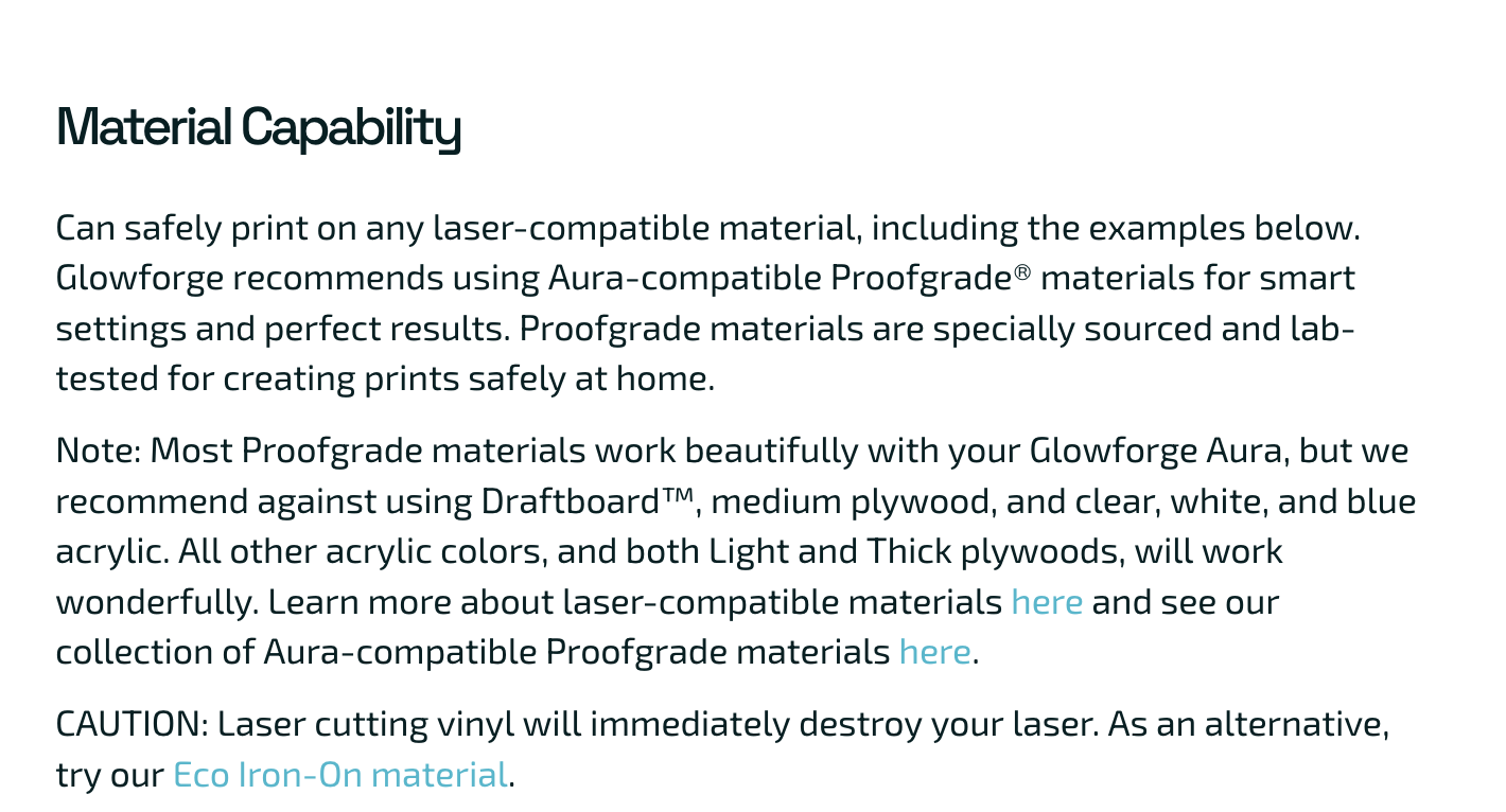

Just so you know, Glowforge specifically recommends that 1/8" plywood NOT be cut in the Aura.
To further clarify, it is the MDF core ply’s that they recommend against due to how dirty it burns under the LED laser. Baltic Birch and the “lite ply” that sells work great.
