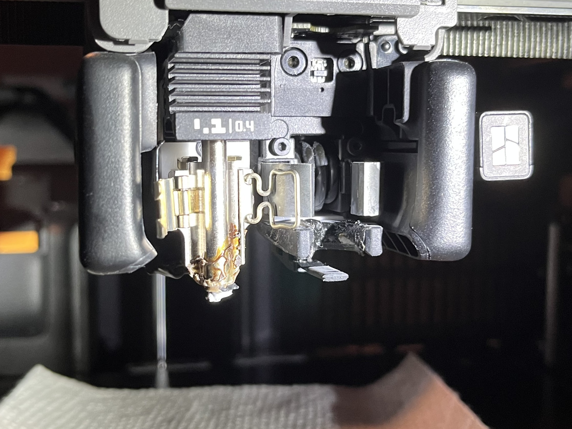

Any suggestions on getting this nozzle free? I assume the filament worked its way between the head and nozzle (underneath the silicon). I went to remove it and it is stuck firmly.
Here’s what Gemini thinks.
Based on the image provided, this is a classic “blob of death” on a Bambu Lab hotend (likely a P1 or X1 series). The filament has leaked (possibly from a nozzle swap that wasn’t seated perfectly or a failure during printing) and encased the hotend assembly in solid plastic.
Because the plastic has solidified around the components, you cannot simply pull it off cold—doing so will rip the delicate thermistor and heater wires, forcing you to replace the entire hotend assembly.
Here is the safe procedure to remove it:
1. Heat is Mandatory
You must soften the plastic to remove it.
* Turn on the printer and navigate to the temperature controls.
* Set the nozzle temperature to the printing temperature of the stuck filament (e.g., 250°C for PETG/ABS or 220°C for PLA).
* Wait for about 5–10 minutes to let the heat soak into the blob.
2. Gentle Removal
Once the blob is soft:
* Use a pair of pliers or tweezers to gently pull the bulk of the plastic away from the nozzle.
* Be extremely careful around the wires entering the heat block (the metal block where the nozzle is). The thermistor (temperature sensor) and ceramic heater wires are very fragile. If the plastic pulls on these wires, they will snap.
* Do not force it. If a chunk isn’t moving, let it heat longer or use a heat gun (on a low setting) to carefully soften the exterior if the internal heater isn’t enough.
3. Cleaning the Assembly
* Once the main blob is gone, use a brass wire brush to scrub the nozzle and heater block while it is still hot.
* Pay attention to the metal clip that holds the hotend in place. If plastic is stuck in the clip mechanism, you won’t be able to unlatch the hotend to replace it.
4. Verification
* After cleaning, inspect the wires. If the temperature reading is unstable or reads “0” / error, the thermistor was likely damaged during the leak or removal. In that case, you will need to buy a replacement hotend assembly.
Would you like tips on how to prevent this leaking fro
m happening again?
While it was incorrect on a lot of things, it was correct that I simply needed to heat the nozzle to 220, then I was able to simple take it off with my hands. I used heat protected gloves, but the part handled was not even warm, just the end of the nozzle where it was stuck.
