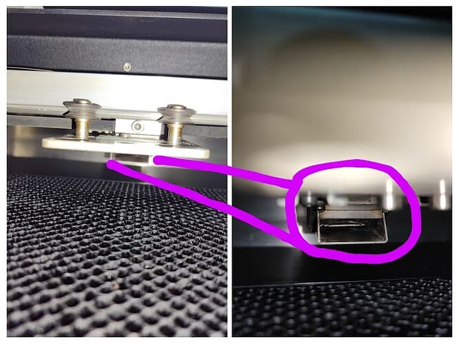

My Glowforge, for months, maybe even the past year, always has the “air assist fan not running at correct speed”, and happens about 3-10 times until I can get it to work. I play with it, pull off the laser head etc and then it works.
I’m on the 50th try today and it’s not working. I have also fully cleaned my machine, unplugged and replugged in EVERY connector and the fan IS spinning, but suposedly not correctly.

So I did, cleaned, unconnected, reconnected – the fan DOES run though, that’s why I think it’s possibly not the fan and maybe a trip up in a safety system.
To be clear, those closeup photos are not of the air assist fan!
The fan you need to clean is the one on the backside of the board - it’s about 1.25" across. There is also a chute on the underside that needs to be cleaned (shove a pipe cleaner or qtip through it).

I actually took that apart and cleaned it as well - and the chute at the bottom. :frowning:
