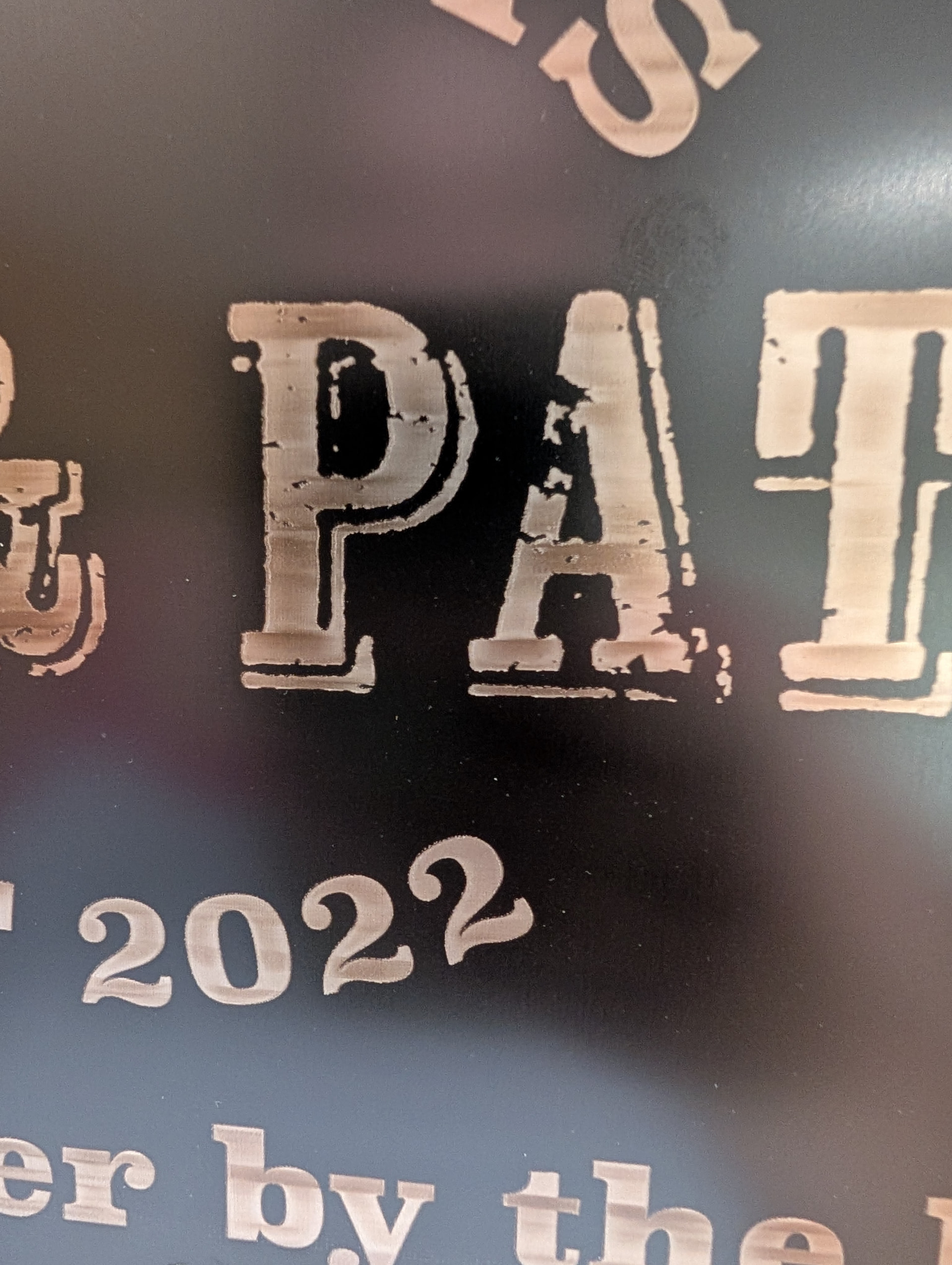

Anodized aluminum etching with a horizontal shadow pattern
I have been trying my hand at my first anodized aluminum project. I grabbed a sheet of this and followed a lot of the guidance in the forum on settings but nothing I do seems to get rid of these horizontal shadows.
I tried:
  1. Slower speeds (Always full power)
  2. Higher than the material focus point (material is .03in thick)
  3. Lower than the material focus point (.01), auto focus
  4. Rasterizing the image and changing vary power, patterns, dots, etc.
I’m totally at a loss. Is this just as good as it gets?

Thanks for all the tips! I think I’m extremely close now. To answer the questions
  • Yes I removed the film
  • I did try to wipe it but nothing comes off
  • I had already run several passes with the same settings then different settings to try to remove the patterning
  • If I run it with a 90 degree turn of the material, the patterning still is parallel to the laser tube suggesting it’s something with how the Glowforge rasterizes I presume. When I rasterized in Adobe Photoshop then uploaded a png, I got some stray dots in between the letters

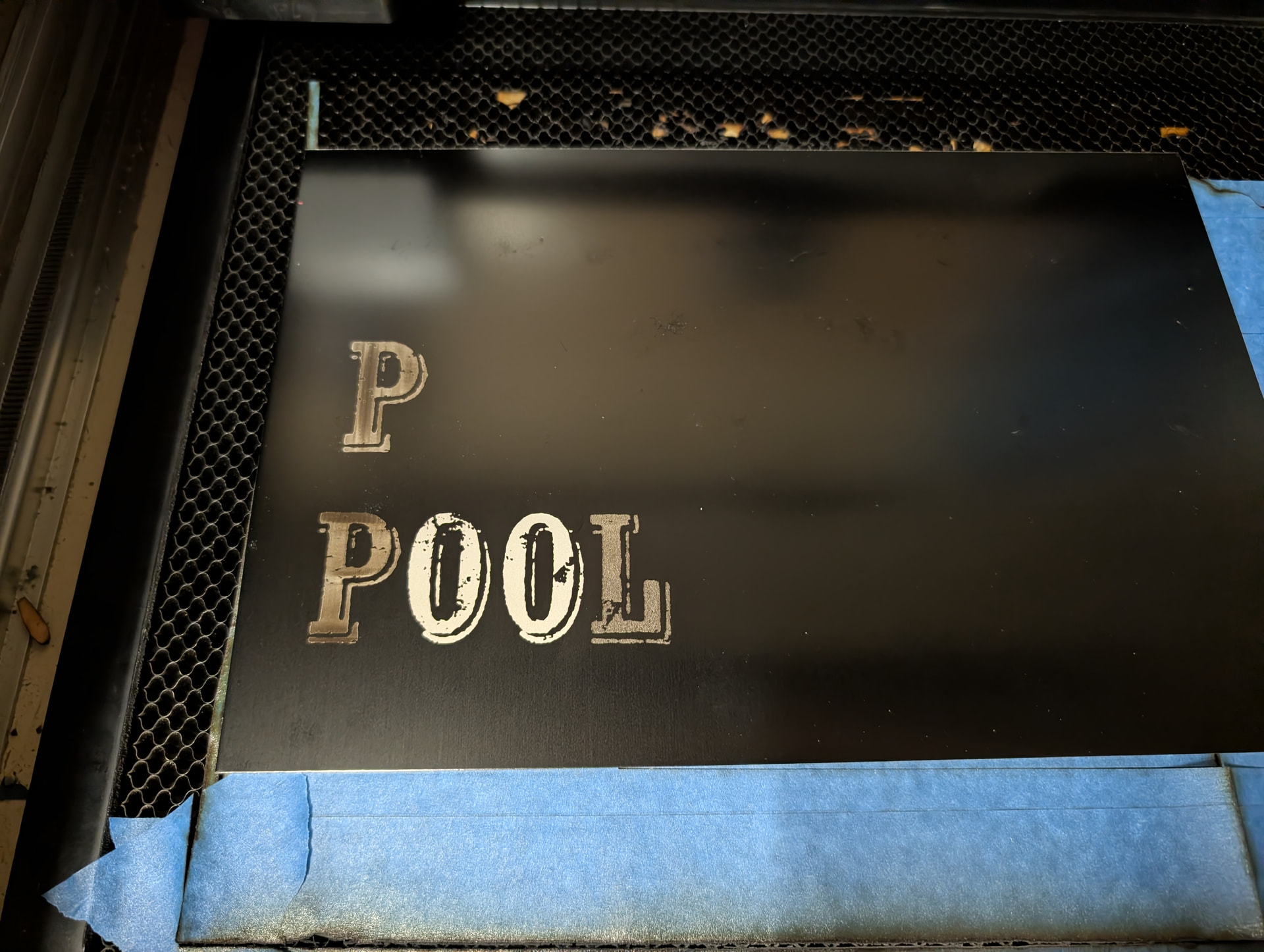

It does look like reducing the power is the trick. The L in the attached image was run at 608, power 79, 340 resolution, 2x. The odd thing - the O’s came out white and they were run with the same settings but manually running things twice. I’m not sure why it’s inconsistent or even which version is “right”.
Kept tweaking and so far the best settings I’ve found are the following:
Speed 300, Power 85, 340 LPI, auto-focus, 2x
Some shadowing effect but not so noticable. Possibly I could run it a bit faster but running out of time for today

Still working on it :slight_smile: I managed to get one sign to look absolutely perfect with a series of passes with the above settings (one with your higher LPI then) the following settings ran and it just suddenly was perfect:
600 speed, 95 power, 340 lpi, autofocus. I’m setting the height of my material accurately.
When I get the settings JUST right, it comes out matte with no horizontal lines, but that seems to be extremely finicky to do. I’m trying now to replicate it with a new design and these settings aren’t hitting that sweet spot any more. I’ll keep at it
Finally got it! I don’t know how many passes are needed since I ran through a few times on subpar settings but this setting worked:
500 speed, 95 power, 340 or 675 res depending on engraving, autofocus
So you can see the difference 100 pts slower made…
Ooh buttery. Nicely done, good job sticking to it.
