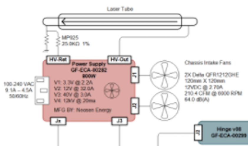

The way you describe it, it sounds like the power supply might have failed. The cutting issues alone would indicate a dead tube but the other symptoms would not show up if that was the only problem.
I’s certainly not a mechanical issue related to belts and rollers/pulleys.
Thank you for the reply.
I knew it would have nothing to do with the belts/rollers, but went along with it any way.
Is there any way to test the power supply ? As its still supplying power to the pump/fans/LEDs .
No, the power supply itself has multiple outputs, but power is then distributed by several of the other boards.
Regardless, it’s a non-serviceable item.
