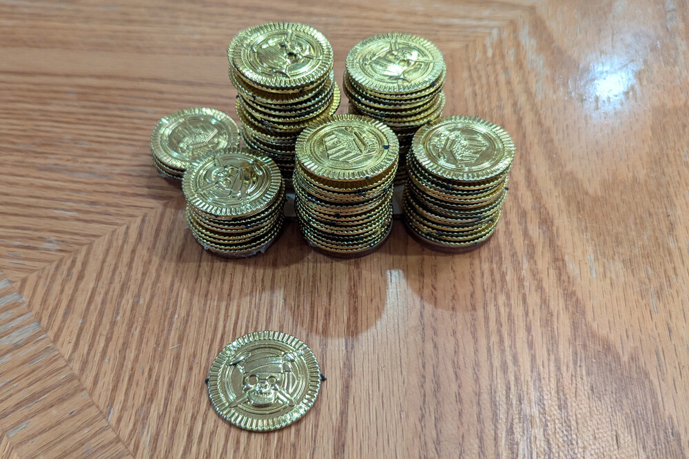

Ebenezer needed stacks of money on his desk, but the plastic coins went every which way during scene changes.
I cut some scrap wood and attached the coins using hot glue, saving a few loose coins for counting.
