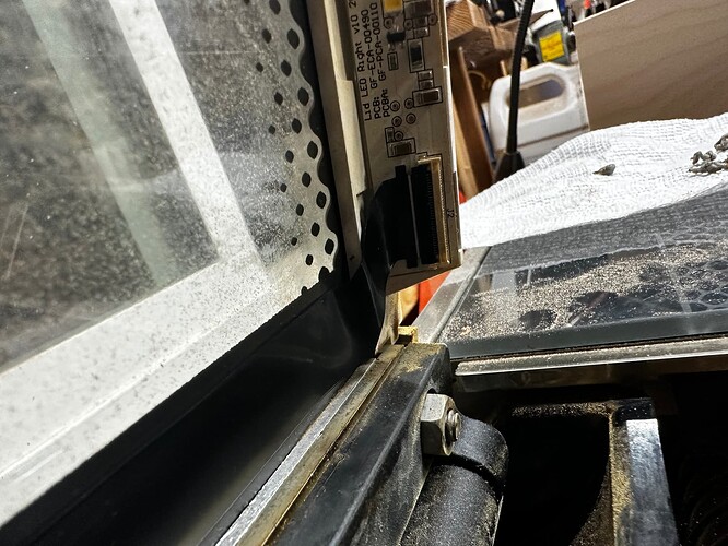

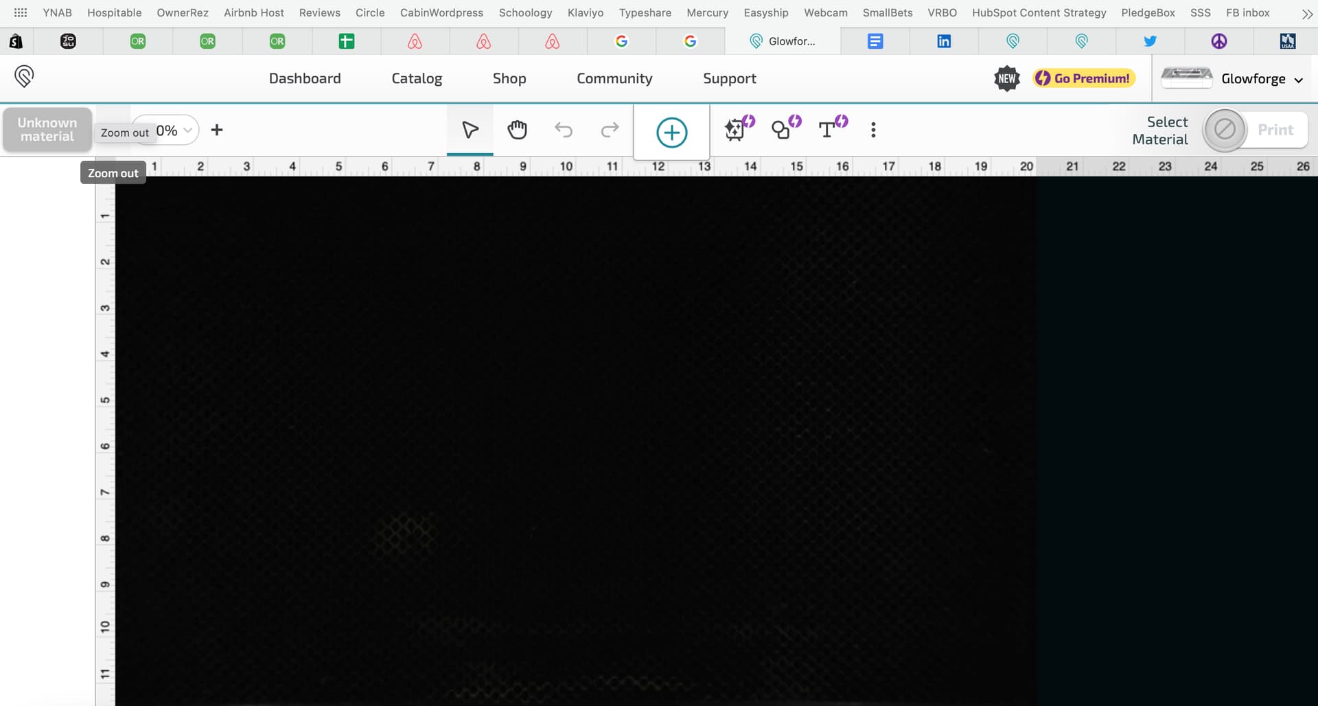

Hi - GF said it couldn’t see the camera, so after troubleshooting, I replaced the camera ribbon (black near far side of lid). Connections seem tight and centered, but after a long centering, homing and scanning, the screen is now black and there’s a circle with slash through it in the top right of the interface. it looks like the camera isn’t working with the new ribbon either, though it seemed to center and home. Any suggestions? screenshot attached.
That is really odd considering it requires the camera to complete calibration. Do the lights on both sides work?
That’s because it has nothing to print, nothing to do with the camera. Looking at your picture it looks perfectly normal! Here it is lightened up a touch:
Load some art, select material, and then see if you’re still having any issues :slight_smile:
ok - that was incredibly embarrassing. You’re right! BACK IN BUSINESS!
