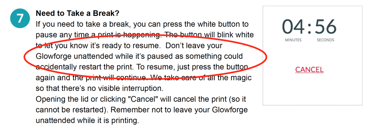

Worth noting, but pause is not meant for you to leave the machine unattended except for the briefest period of time. You should not leave the machine unattended for an extended period while paused.

Do what you please. I just know I won’t leave my machine unattended, and the manufacturer seems to agree.
“Something” = cats, small children, etc. It’s not going to restart itself. :slight_smile:

Regardless, my statement was simply that the machine should not be left unattended, which is what is stated in the manual.

Correct. You can pause as long as you like, I never disputed that. I merely pointed out that the machine should not be left unattended while paused, which is what Glowforge states. Not quite sure how that advise is “my own” when I am directly quoting the manufacturer.

ulp! I never saw that before.
They recently expanded the instructions. (They’ve got a whole new section for Instructions now that’s really nice. And i’m sad to say, I didn’t see it right away either…too much other stuff going on.) They snuck one in on us. :slightly_smiling_face:
