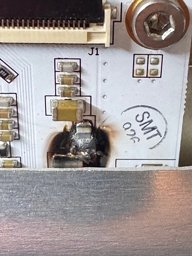

Does anyone know what the problem might be here? Looking to purchase a used Glowforge and I don’t know if this is a major problem. Any help would be appreciated.
Is that where the black lid cable goes in?
I think it is where the cable goes in. I’m not with the machine so I’m not sure. But it’s possible to replace the circuit board? I’ll look at the link you included
Well check with support about this
That part is not meant to be user-serviceable, it is not listed as an available part. I am fairly sure the owner in the linked thread was only able to obtain a replacement because of their location, and the ridiculous cost of shipping a machine back for repairs. There is also no guarantee that replacing it would solve the problem, as damage there could have also resulted in damage deeper inside the machine.

That is the most common problem with folks who decided to “deep clean” their glowforge. That card gets even a little bit wet and that is the result. I think these guys sell that chip but it is a risk that anything else is wrong, but probably worth it.
