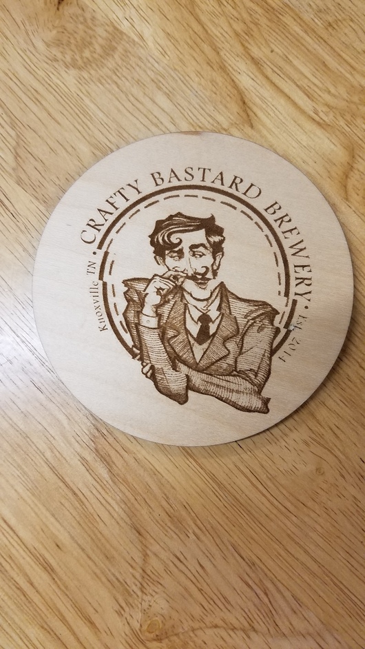

For the last several days, the unit has only been able to successfully calibrate when the head is placed under the camera. Moments ago, I ran two identically designed coasters at the same time and the differing results are shown below. They were positioned on the upper and middle right side on a left and bottom justified 12 x 20 Proofgrade maple plywood. I didn’t pay attention to be able to tell you which was uppermost.
The good one:
The bad one:

Wow, Crafty Bastard #2 is just sort of melting off of the coaster. I rather like the effect, but can definitely see how it’s not what you were going for. It’s also an unfortunate waste of material.
I am trying to wrap my brain around what could cause this error mid stream.
Might have been a corrupted file download somehow? Can’t imagine anything else that might have caused one bad one out of the two.

Looks like a layer shift I sometimes see in 3D prints, 2 reasons for it:
A. Slipping belt, so one or more fixtures between the head and belt (if the GF has any) is/has become loose. This makes it slip when doing a rapid change of direction. It continues for a while on that slipped location and then after a while it slips a bit more. Maybe someone from GF can clarify if this can be the issue. I guess it really is something like that. So hopefully a screwdriver and some turns can fix it.
B. Like Jules said, corrupt file, glitch, sunflares…
Hope the issue is fixed soon!
Measure the offset to see if it is a multiple of 2mm (which I think is belt pitch) or 1.2mm (which I think would be four full motor steps).
I wouldn’t call this an alignment issue. It looks like the image was not rendered properly. That would be better than a belt slipping.

Thank you everyone for all of the help. @volivaa, I’ve followed up with more detailed information through email; however, it appears we need to replace your printer.
I’m going to close this thread, but please reach out to us if you have any other questions!
