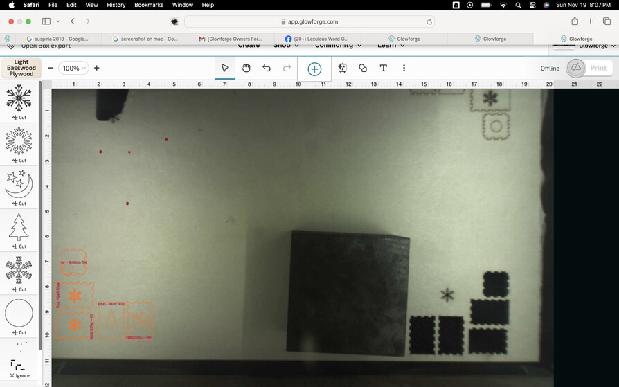

I am beyond frustrated! I am using vector images (many of them from the Glowforge app) , using proofgrade materials and proofgrade cut setting (as well as many others that I tried) and I can’t get the machine to cut!! What am I doing wrong.

Can we get a little more information - what machine are you using (Aura or Glowforge) and can you share a screenshot of the interface including the speed/power settings?
Support is likely to ask you to print the ‘Gift of Good Measure’ which is a known file supplied by the company that uses all the functions, engrave, score, and cut. Then send them pictures of the front and back if it didn’t cut through. The results let them evaluate the machine’s function.

I am glad the Gift of Good Measure cut properly. This means your machine is working well and we need to help you figure out what is going on with your other files. Please share a screenshot of a project that isn’t cutting properly.

Where did you get the snowflakes? If it is from the Noun Project stuff in the GFUI there are many that will not cut properly as doing so is not something the Noun Project is explicit about.
Good question. If you’re using artwork in the GFUI from your premium subscription, they will only engrave…not cut. They are raster images. You would need to make an outline around them with a vector line in order to cut them out.
From Glowforge!
Sorry wrong thread. Yes Glowforge has paid Noun Project to have access to their stuff, but some of it is not best for the job

Do you mean convert them to a vector image? Why wouldn’t glowforge only provide vector image?
