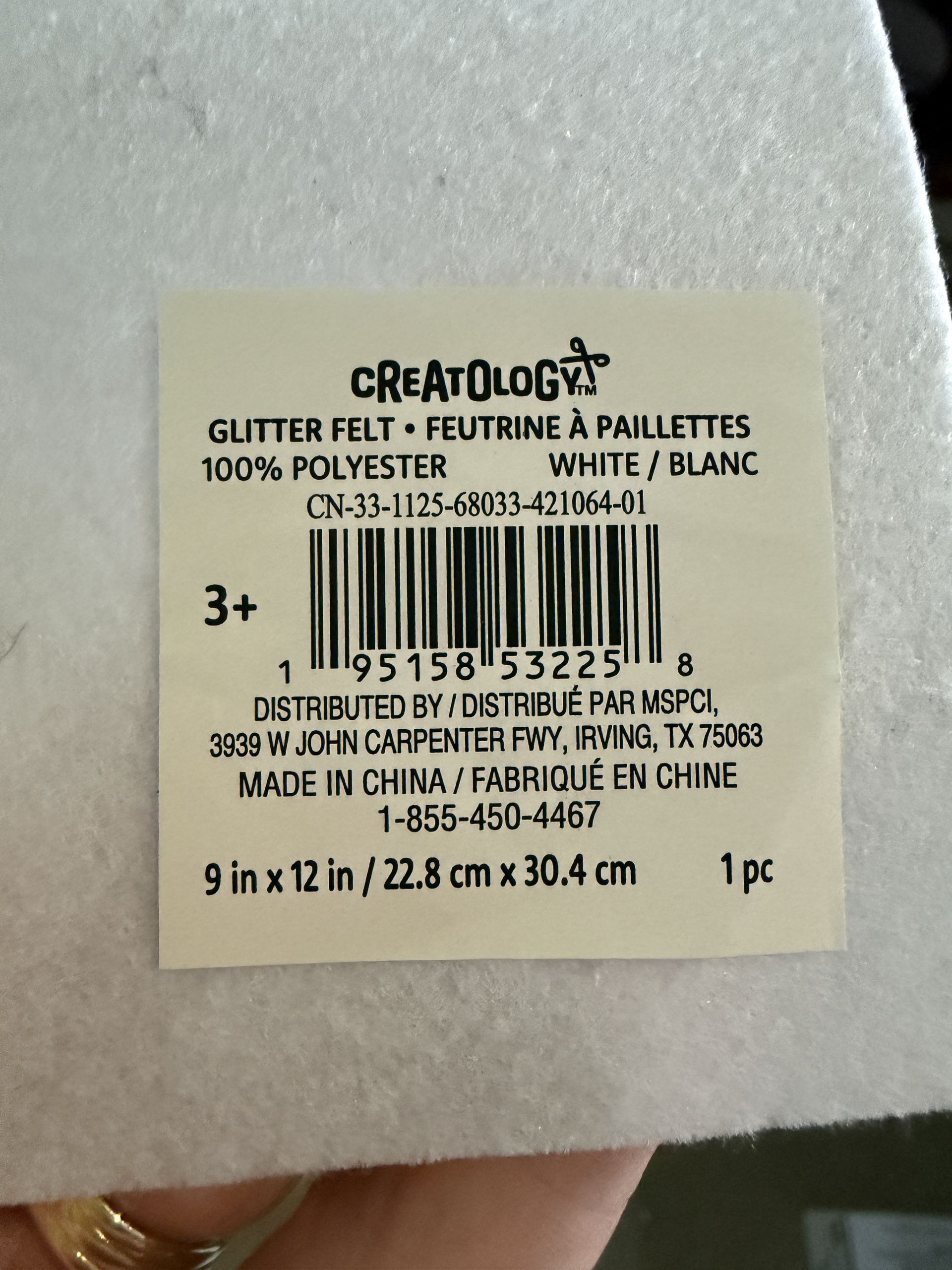

Creatology Glitter Felt settings on glowforge aura?
what settings to use on this? Thanks in advance.
Welcome to the forum.
When using non Proofgrade materials, you will need to do some testing to determine proper power/speed settings. Use a small, simple design (like a circle or square) and start with a setting for a similar Proofgrade material. Since there are no Proofgrade fabrics, maybe start with the setting for 80 # cardstock and adjust as needed. Make sure to watch carefully when testing on light, thin material like this felt as you don’t want to start a fire. You want to cut with the fastest speed, lowest power setting that delivers a clean cut.
Hey, welcome!
Pretty much any settings question you might have is answered in number six on my FAQ:
A special note for you since you have an Aura: blue materials don’t cut or engrave very well, if your felt is a blue color it may reflect the laser light from your aura.
Like @dklgood (and my faq entry) said, testing is going to be important.
