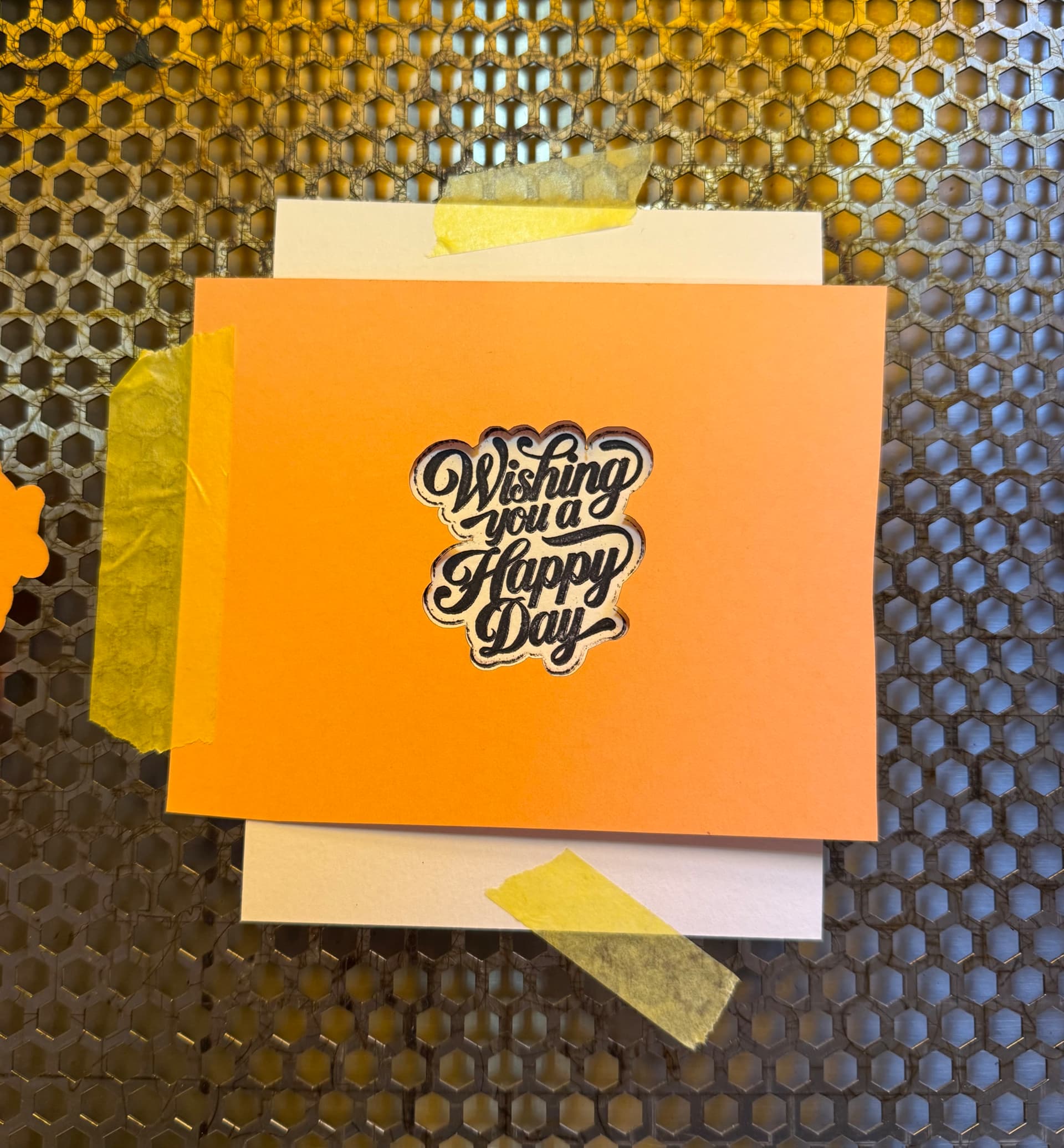

  1. The finished plate does come out a little warped due to the heat, and that leads to an inked outline when you use it on the BetterPress. We can trim that off later.
  1. To trim the letterpressed piece, tape a piece of scrap card to the Aura grid. Move only the image outline to the card, and reduce the size of the outline by about 0.03 inches. Cut the outline, and without shifting the card, center your letter pressed image under the cut outline. Tape the letter pressed piece to the grid and remove the scrap card. Cut the outline.
(In the above example I did not reduce the outline width and there was still residual edge ink after cutting).
I plan to try this process with thin basswood sheets to see if I can get less warpage and not have to trim off the outline. Also, I did these experiments with cheap cold press watercolor paper, not letterpress paper, and Ranger Archival ink rather than letterpress ink. So it’s likely I can get better results. This is a work in progress!

When I did leather pressing I saw the same edges and actually double engraving the stamp addressed that. It made it flimsier in the long run, but as I could make new ones as needed I didn’t worry too much :stuck_out_tongue:
Maybe worth a shot?
Good idea! If I do it only around the edges, it wouldn’t take so long (original engrave was nearly 2 hrs).
