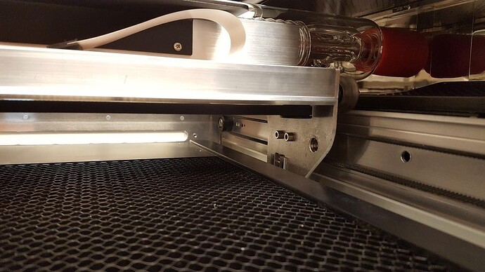

I’d like to see if we can get a photo of your right side belt and pulley as well as the print bed. Once we have these photos we will be able to provide the best next steps. Thank you so much.
Thanks for all the replies! Here are the photos…

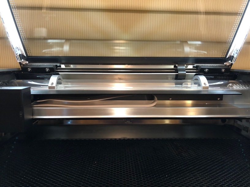

Hi @Purplie. Thank you for sending those photos of the side belts of your Glowforge to help troubleshoot the unexpected print results. I was able to review the photos and didn’t notice anything of concern, but wanted to follow up to see if you had a chance to take photos of the following parts @Faryar mentioned. This can help us rule those out as any potential cause and decide any next best steps.
1.The belt under your laser arm with the head pushed to the left:
  1. The pulley under the laser arm on the right side from the front:
  2. The right side pulley under the laser arm from underneath:

The “Gift of good measure” came out fine, as did some other prints that weren’t in the extreme corner. I did a second test of the extreme corner and got a better (but still visibly not straight) result (see photo). The other photos you requested are below.

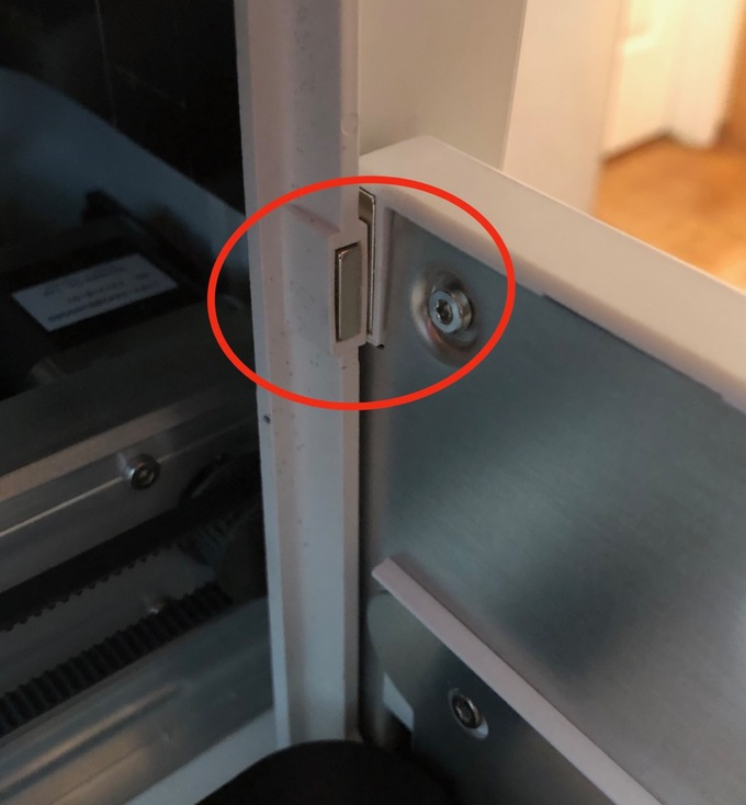

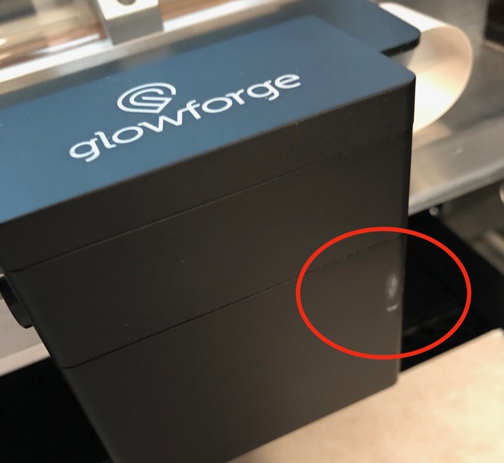

But, I think I’ve figured it out. In the corner, the print head is banging up against the right-hand magnetic latch of the front door, causing the print head to wobble visibly. Hence the white smudge visible on the print head (see photos).
Does this mean I need to do some recalibration?
BTW, I notice that the magnetic mount of the print head doesn’t prevent a slight wobbling forward and backward, in response to a very gentle pressure from a finger. Is this normal? It seems to be stable during printing (except when it bangs into something). Maybe this is by design, to avoid damage in cases such as this?

As for the printer head moving that looks to be within specs.

I verified there is no debris in the divots, and the crumb tray is properly settled. Cleaned the white smudge. Ran the print again, and took a video; you can see the print head getting slightly kicked back when it hits the door latch. As before, it left another white smudge.
