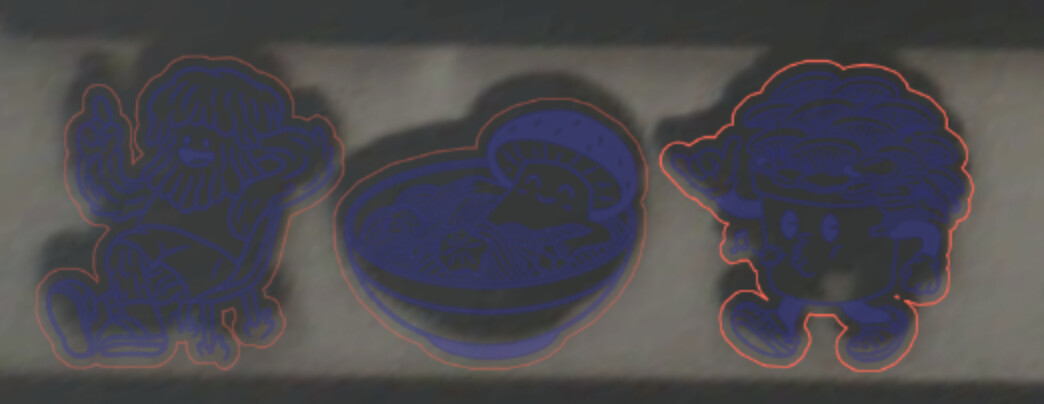

I have a fairly new Glowforge Pro (had it for a couple of months) and recently the image preview isn’t showing where the final cut & engrave is happening.
You can see in the image below where the preview is saying it’s going to cut, but where it actually cut meant the tops of the items were cut off.
Any advice on what I need to do would be appreciated - am I’m new to this I don’t even know what terminology to use when searching for a fix :slight_smile:

I already have the ply pushed back from the edge, as I had realised that it didn’t cut so well close to the edge. I am also finding that it’s not cutting through the wood properly - I am using glowforge proofgrade while I’m learning, so I had thought that the settings would all work perfectly every time. Would a camera realignment fix that too?
Possibly? Generally the camera that handles alignment doesn’t affect cut performance*. I’d suggest reading #5, and possibly #21.
#5 addresses common troubleshooting for cut issues and #21 gets into the slightly more complex issue of cut performance that changes across the width of the work area.
* So there’s a part of the alignment camera process called set focus. Not only does it help get better visual alignment but it also tells the Glowforge exactly how far away the material is so it can focus the laser for maximum cutting performance. Technically the focus depth and the alignment camera image are separate things but they’re definitely related in that they are adjusted in a single step.

It is not at all normal for a new Glowforge to fail to cut through Proofgrade materials using Proofgrade settings. In fact, Glowforge will reimburse the cost of materials if it is shown that their products didn’t work as warranted.
The lid camera is a tool for placing your design, but does not influence the performance of the machine. In your photo, it appears that the material did, in fact, cut through, but the cut is higher than expected. Is it possible that the printhead or laser arm was moved with the machine on? Does this happen with every cut? Are you using the set focus tool prior to placing your design?

@dklgood yes, the cut did happen in that picture - my previous cuts didn’t work though, I just didn’t think to take a screenshot at the time.
I have made a few changes that seem to have made a difference. Firstly, I did a camera realignment, as I had wondered if something had been moved by mistake. And I cut some honeycomb pins to hold down the board. Finally, I’ve also split my 12x20 board in half, so that it’s not sitting against the edges (so I can use every bit of wood).
I am cutting the items again now, as it seems to be working as planned :crossed_fingers:
