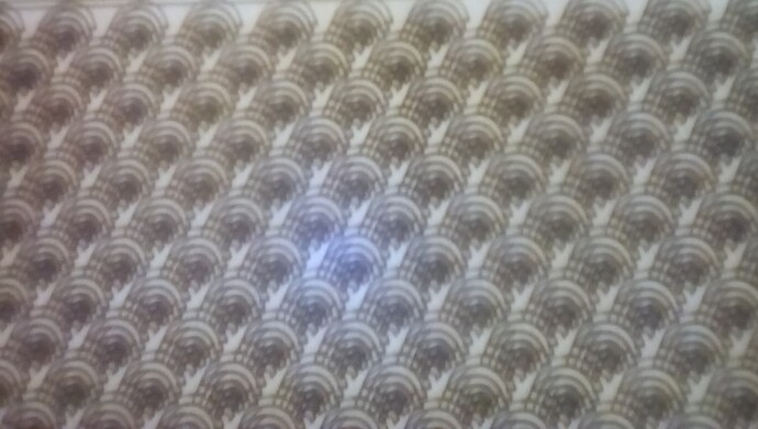

When mine was slipping quite a lot, I got this…
