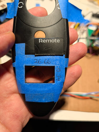

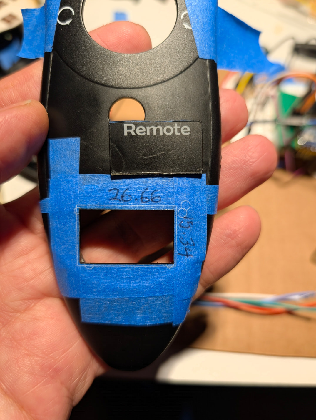

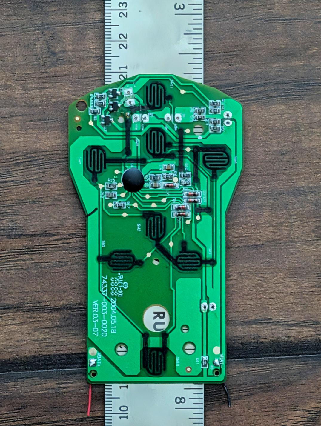

Sometimes, because reasons, you might want to replace the motherboard inside an old remote control.

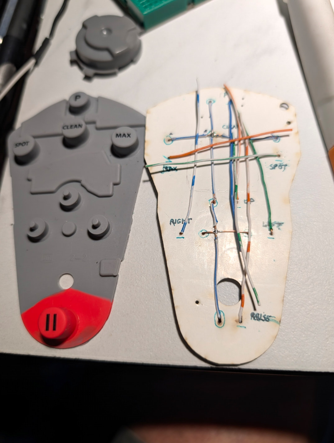

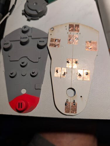

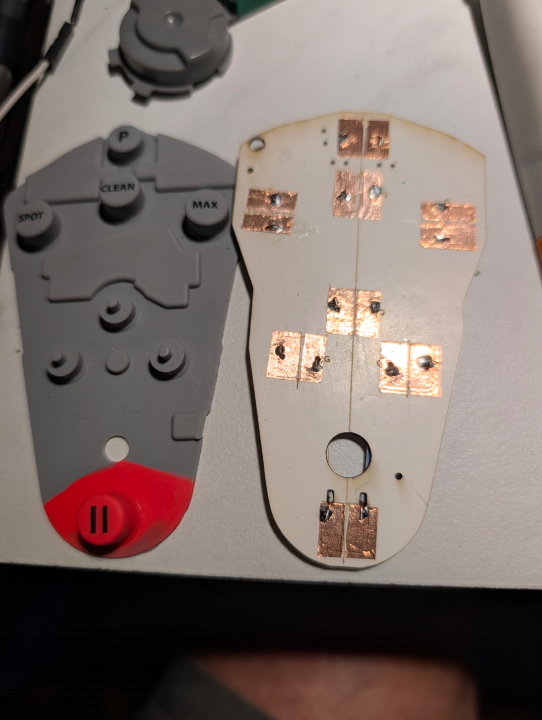

Some thin paperboard and a few measurements later and you can apply copper tape for the button contacts.

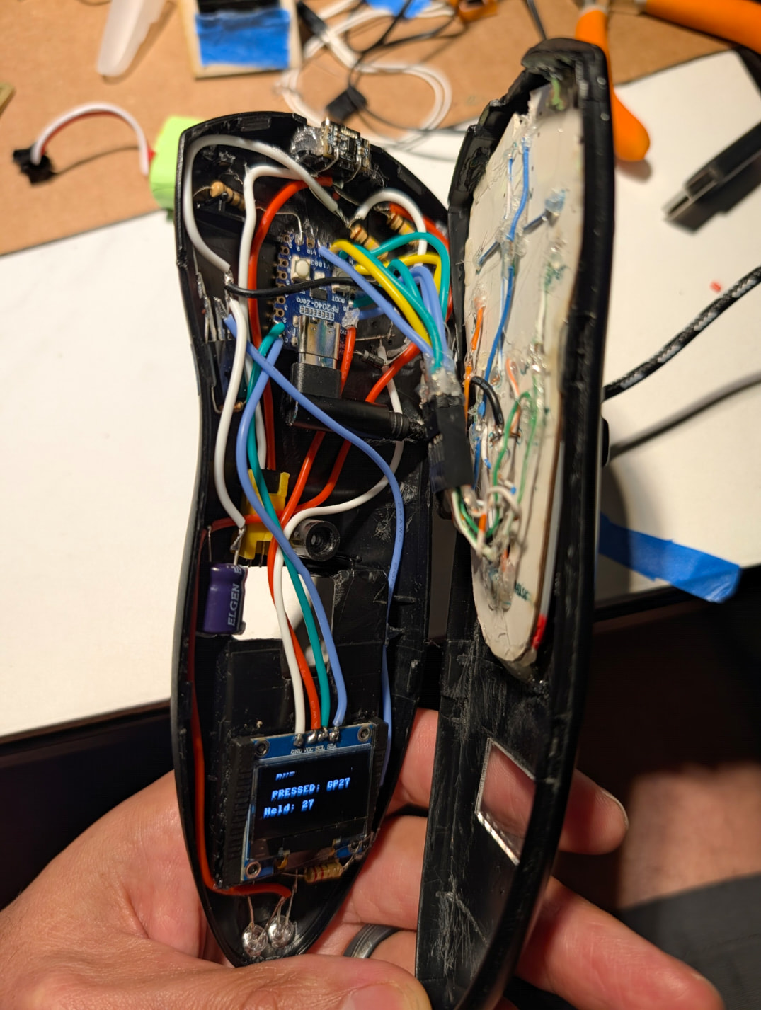

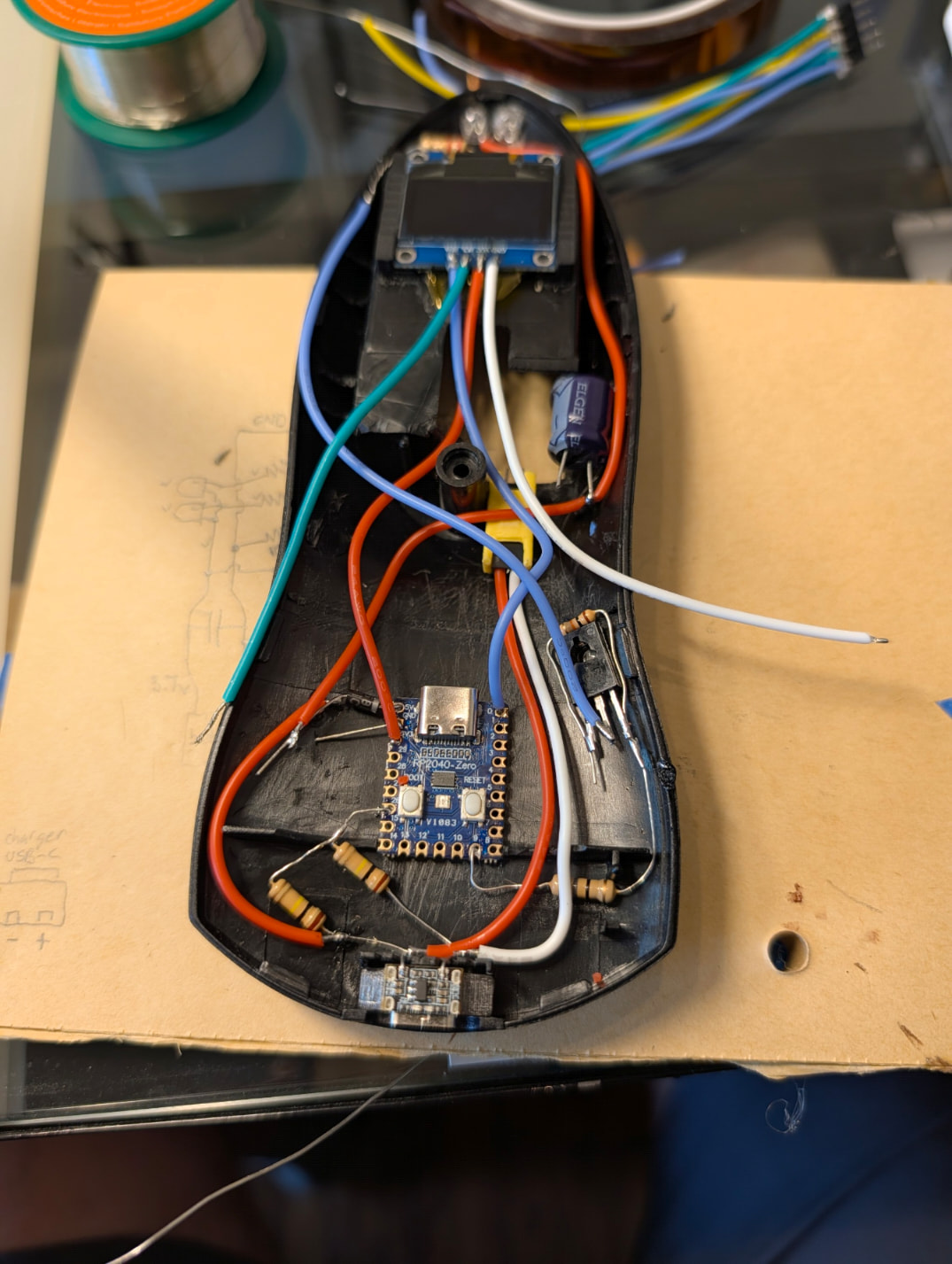

Insert wires from the back, solder, and you’re on your way.
A minor modification to the shell…
Some creative wiring…

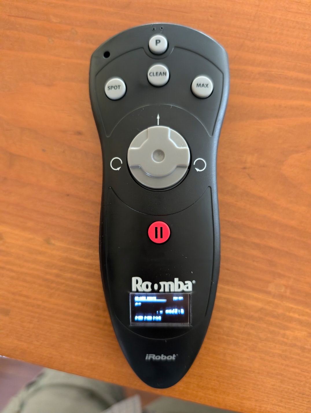

And a win!

Paperboard? Never would have thought to try that. It’s rigid enough?

Yes, paperboard, about 4mm thick, was rigid enough with some support built into the shell.

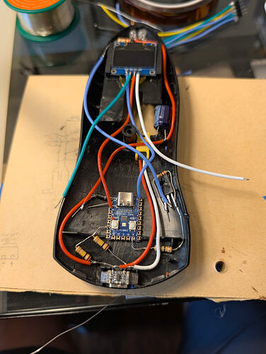

I was resurrecting an electronic bidet for which 90% of the functionality was provided by a missing remote that could no longer be purchased. The Roomba cleaning buttons turned out to map nicely, and the OLED plus navigation wheel made for a nice menu system.
Programming microcontrollers is ridiculously easy with AI these days! The bulk of the effort was jamming everything into that small area, thus the need for a very thin PCB.
