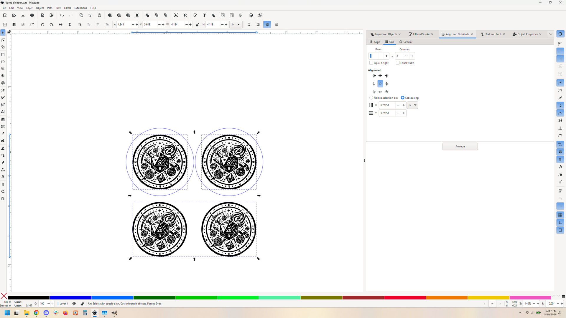

So an svg can contain embedded rasters (jpeg, png etc). Essentially you use your vector editor to combine them into a single raster after you’ve laid it all out. How exactly you do that depends on which editor you’re using. I use inkscape, and the method there is to use the “make a bitmap copy” function.
Here’s how that goes.

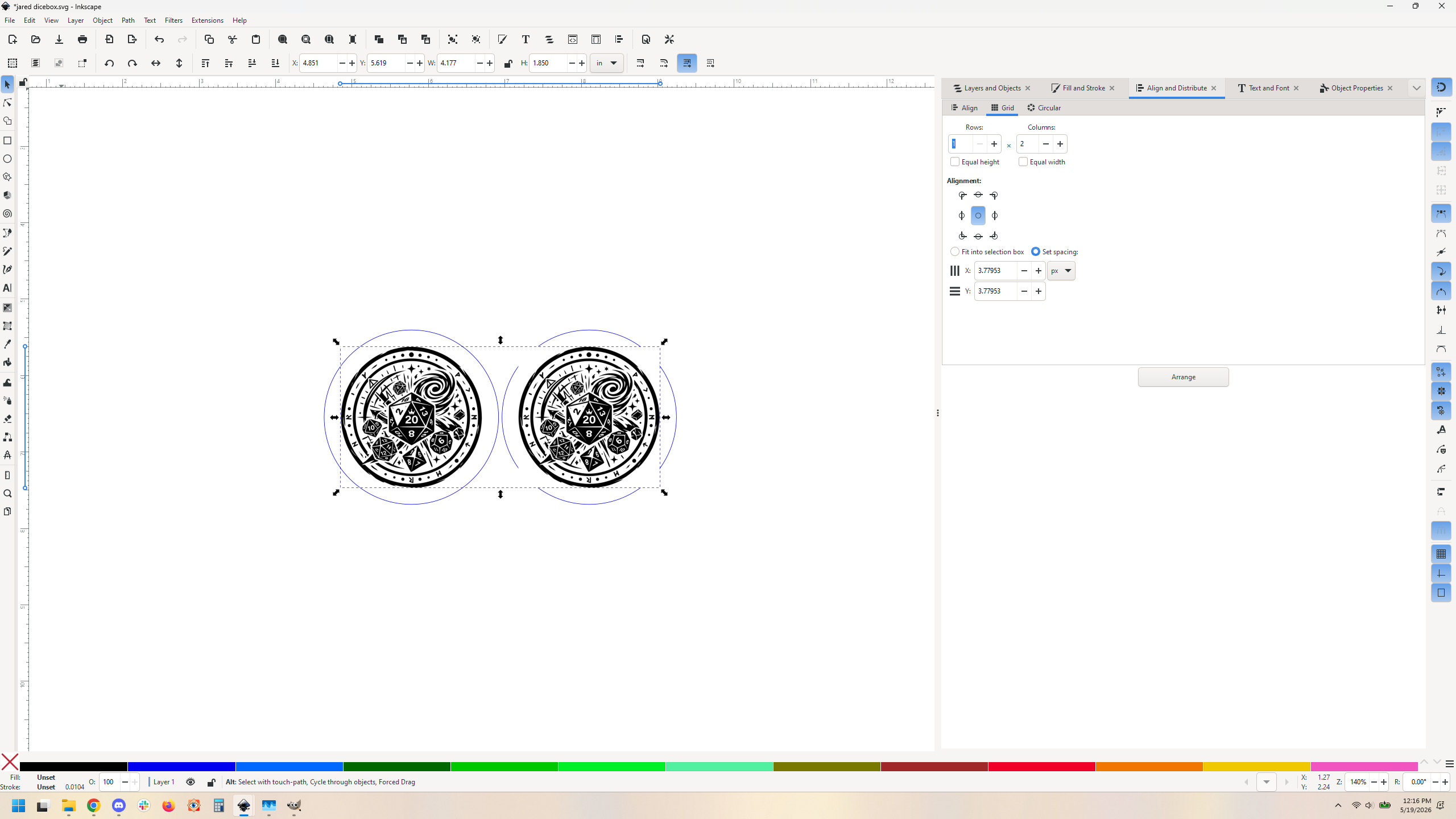

Start with a laid out array of bitmaps with blue cutlines surrounding them:
This isn’t ideal, each of the two images will engrave separately and take a while.

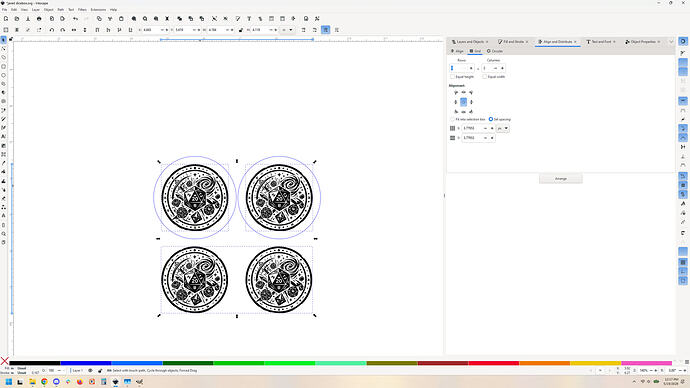

While they’re both selected (and only the rasters, do not select the vector blue circles. you choose Edit→Make a bitmap copy. This combines them into one larger raster (bitmap):
If you look closely you’ll see that the white background of the rasters covers up your circle, no big deal. You can fix that by moving the images back underneath your vector blue lines.
The trick here is that this made a copy. If I move the new combined raster you’ll see the originals underneath:
You can either remove the originals by carefully moving and repositioning things or you can ignore them in the GF user interface.
That’s all there is to it using Inkscape.

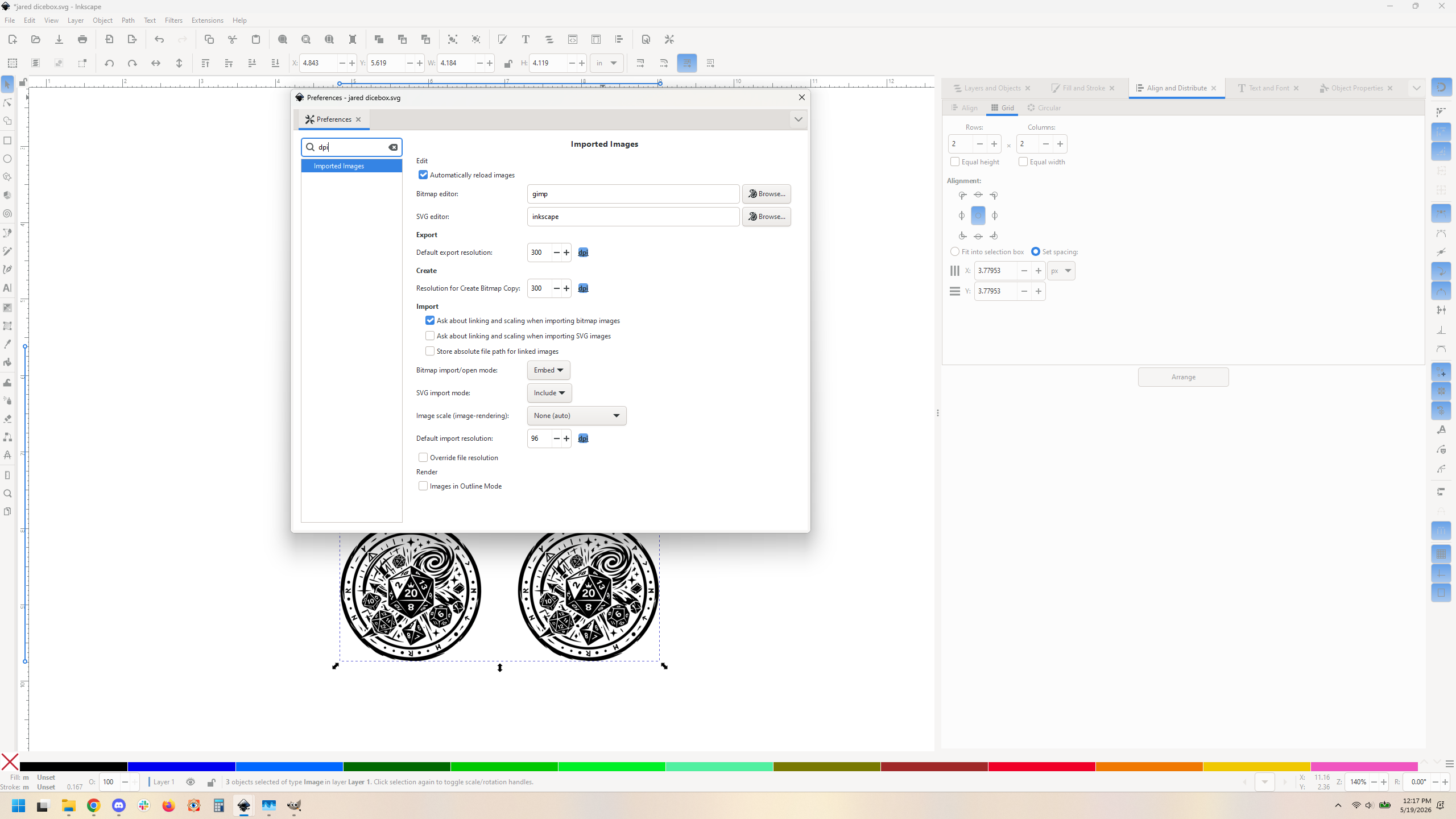

However. If you are using inkscape it’s important to understand what DPI you want in your bitmap copies. That’s in preferences:
I prefer 300dpi for most things, 600 in extreme cases (engraving super fine details on anodized aluminum for example). A good way to think of it is that 300 dpi is about what a paper laser printer outputs. In general it yields a good result.
In inkscape I believe the default resolution for make a bitmap copy is 96. You won’t be happy with that, you’ll notice “jaggy” edges. Set your DPIs like I have them in that screenshot, I think you’ll be pleased.
