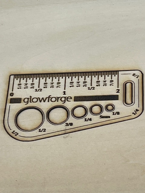

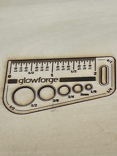

The best way to test this out is to do a test print - can you print out the Aura Ruler and see what happens? This will help you to determine if the problem is with your project (song lyrics) or the machine.
I can see it is messed up, but we need more context to determine what happened. Can you print a smaller file - on Proofgrade material using Proofgrade setting and post a photo? I suggest printing The Glowforge Gift of Good Measure on one of the light plywoods. That is a known file with engraving, scores and cuts. Seeing how it prints help diagnose what might be going wrong with a machine.
When the machine starts up it sets where 0,0 is and keeping track of the motors decides where the head is. If the head stops or is moved by something other than the motors the 0,0 location will change by that much. This is obviously what happened. Why it happened is less obvious.
However, the Aura is very sensetive to dirt build up on the rails and that is a frequent cause of that kind of jump.
Cut it perfectly.

It printed it out perfectly! So, now what? I’m so confused.
This photo clearly shows a machine that is working properly. The problem you are having with your other project must be related to the file, the material and the execution by your Aura.
