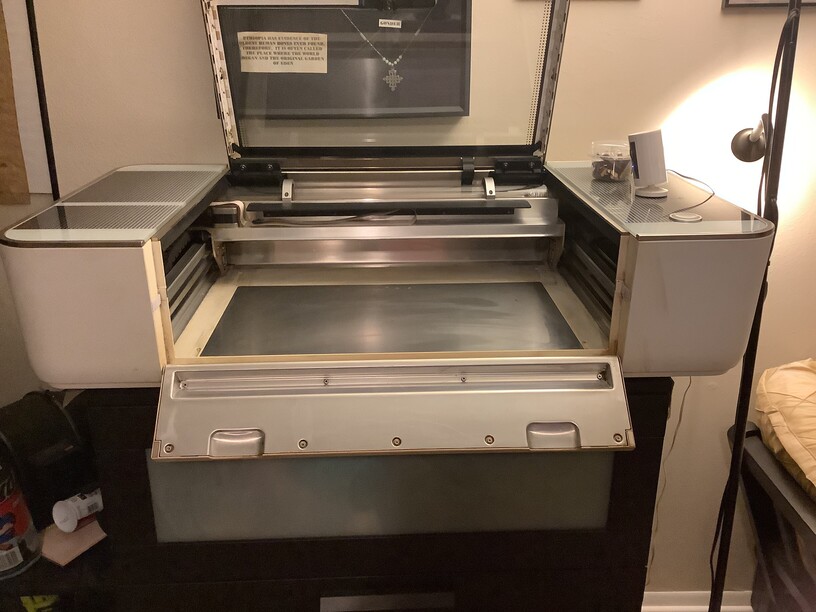

strong textSays it won’t take a picture. I changed the air assist cartridge. I cleaned the Glowforge. I think I heard something fall off the LED strip on the right side which won’t turn on now.
The video said to change the lid cable, so I did. That did not work either.

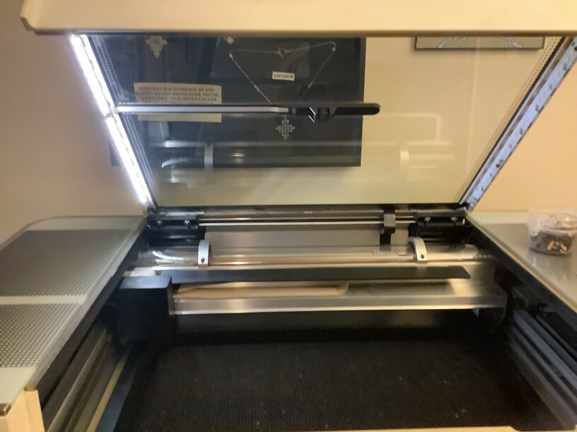

I’d already had an extra cartridge plate and lid wire cable. I changed both of those. I think I wiped the right LED strip to hard ( thought I was being gentle) and now the right LED strip won’t come on. I should have just left it dirty. The error message is that camera was unable to take a picture. Nothing is moving.
Curious: the print head won’t move (yes manually/ no electronically) after I put the new air assist cartridge on. The error message of “ unable to take a camera image” comes on immediately. Did that happen to you?

If your right LED strip is down then your machine is probably not going to be able to read the state of the right sides lid sensor and would therefor think your machines lid is open. The machine will not move if it thinks the lid is open. I would certainly try with that first.
Changing your carriage place should not effect the ability to take a camera picture. You might be getting the error for the camera image delayed. If you download your machines logs then you can see if that is currently an error for the machine.
