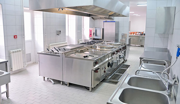

Has K always been around or is that newish?
That is fairly newish, when I had to take fire safety training a few years back when I switched jobs on the Mil base I work on, K was in an experimental stage, and they were telling us about the pros and cons especially in specific aspects of the base.
