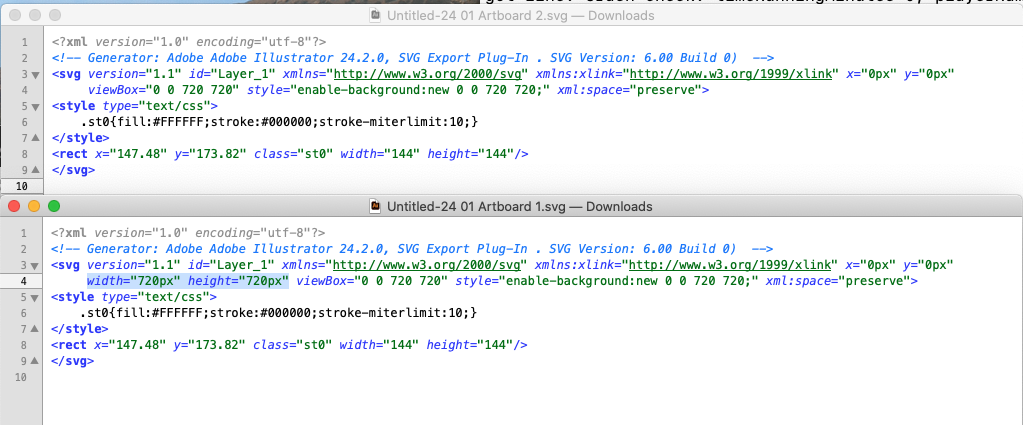

I just played with itā¦ and unfortunately unchecking responsive doesnāt help us.
It seems that iOS Illustrator is always using Pixels as the unit of measurement when exporting SVGs (even if the document is using Inches as itās unit of measurement).
Hereās an example SVGā¦ basically a 2 inch square.
I highlighted in the second one what āResponsiveā doesā¦ it just adds
width="720px" height="720px"
which unfortunately suffers the problem of a different PPI (pixels per inch) than GFUI expects.
But Adobe does seem to keep improving Illustrator for iOSā¦ so maybe theyāll address this.
Hope it arrives soon for you
Thank you for examining this, it certainly keeps me from wrestling further with the program and just opting for the scaling process!
