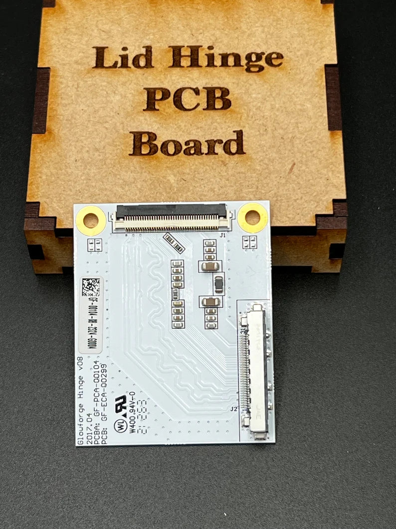

The Black cables are back-ordered but the board most frequently damaged is here…
Also sold out. I don’t know if it’s just the lights, The whole thing is behaving strangely now. I think I am going to have to send it to Wiregrass to get it diagnosed. I exchanged emails with GF support on Sunday and he was mostly clueless about… well, everything. But he said my logs showed a communication error between the logic board and the print head. But he also said something about the ā€œyellow buttonā€ error, which I have not had, so he may have had me mixed up with another support case. Point is, GF support may not be helpful going forward, and I may need an expert to actually look at the unit. All I know is I can’t afford a new one right now.
