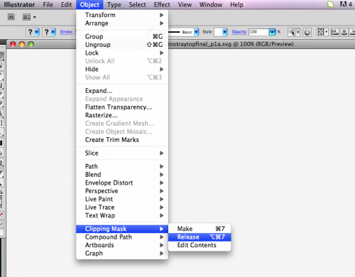

I’m curious as to how Illustrator works these in. It seemed to be a clipping mask applied to the whole group. At least you know where to look for it if it is Illustrator.
Here’s a link to Ponoko addressing the issue.
Hmmmmm. Is it possible that we had something other than a clipping mask? I went back into the Illustrator file, selected all the cats, and checked for a clipping mask: none (greyed out)–the only choice was Make.
So then I opened the pdf file in Illustrator and did the same thing. Same result–no clipping mask.
Weird. Can you make another file, just some squares and circles and send them to me, email, as native AI and also saved as a PDF and see if it pops up again.
Otherwise it is no big deal. At least now I know what to look for and correct it.
