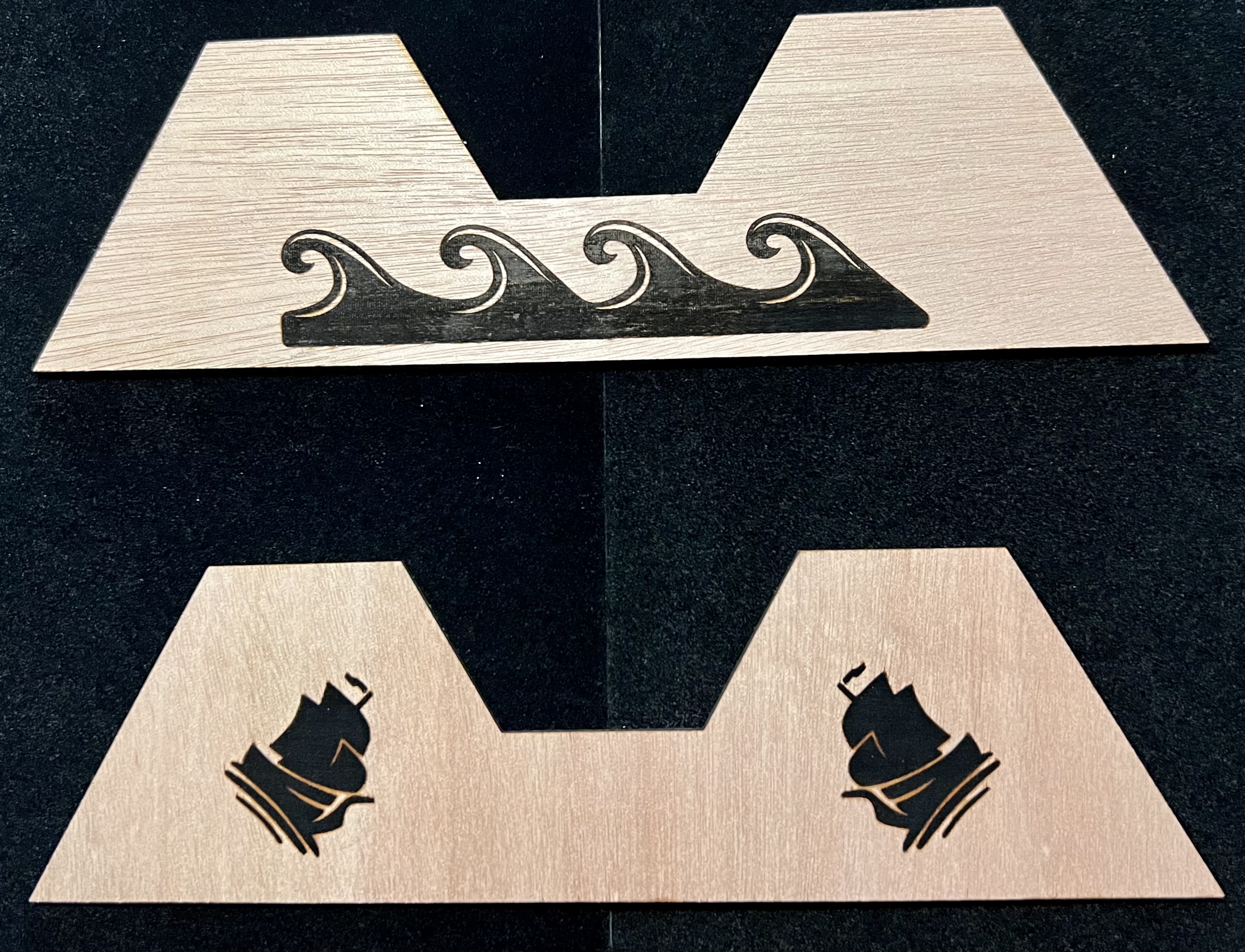

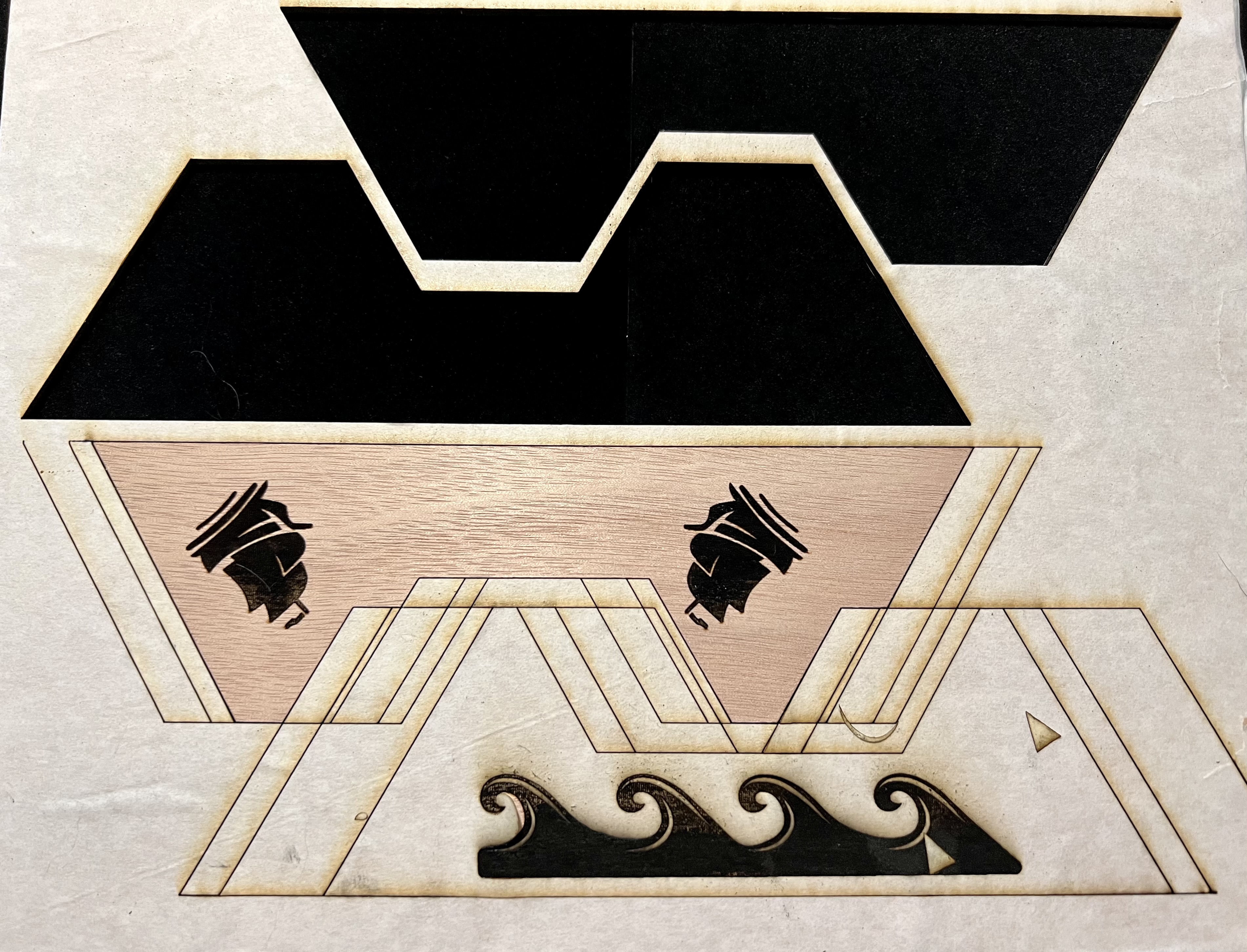

Has anybody else had this happen and know what the cause is? I did a copy paste of some layers, two print just fine, then on the second ones these ghost layers are being cut/etched. The layer settings were identical and there is nothing in the app showing these other random cuts.
I’ve had this misprint issue a couple of times now on different files and can’t figure out what is causing it.

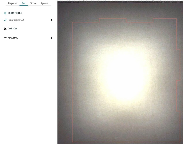

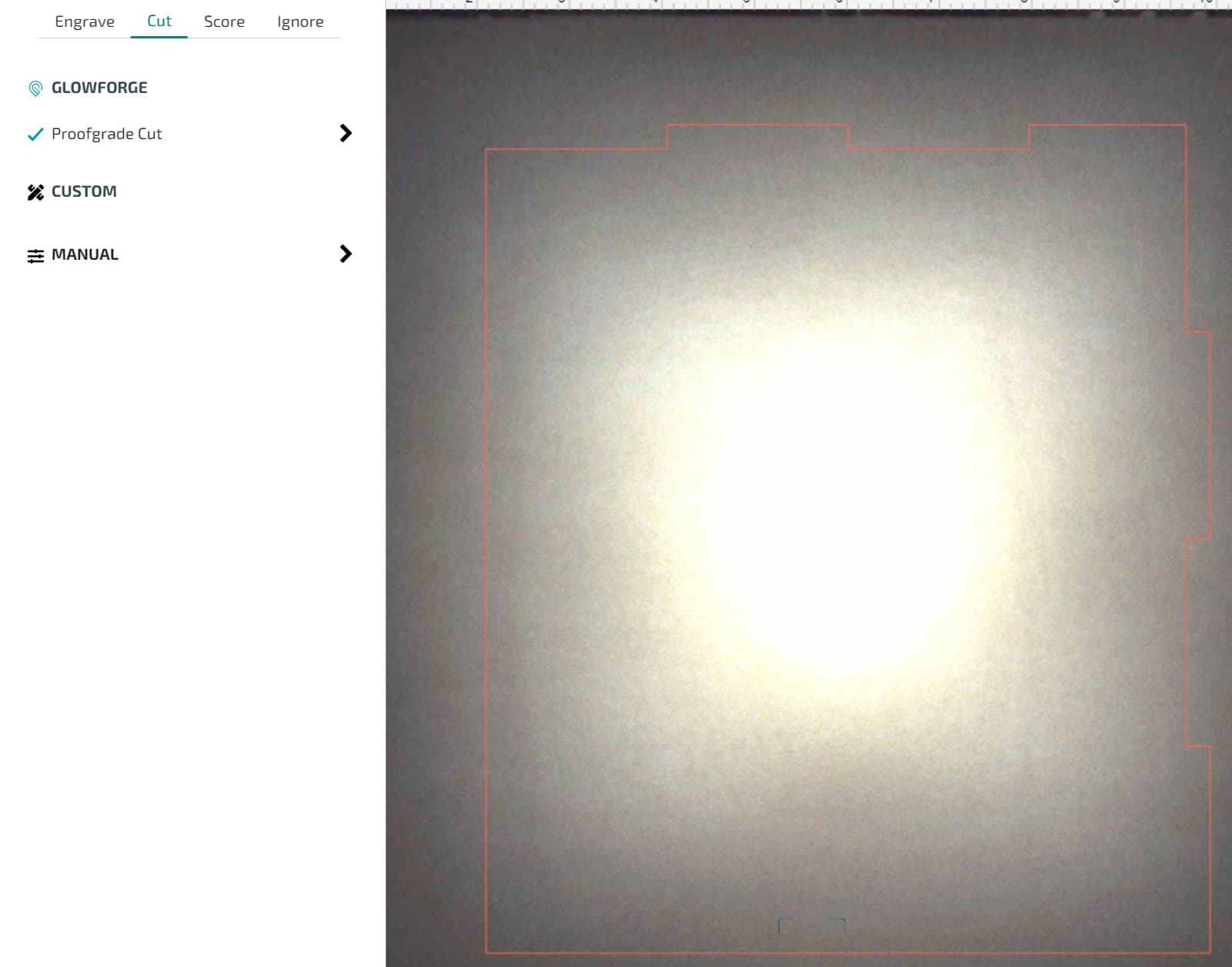

What does does you GFUI look like including the left side panel with all the operation steps show?

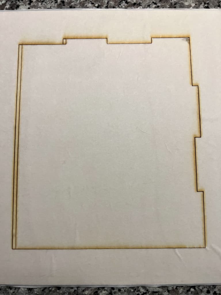

It looked completely normal. No error messages, no phantom layers, nada. I should have taken a screenshot but did not.

I’ve been able to replicate the issue with a completely different file. Used the exact same tools to create/validate, and having the exact same issue.
