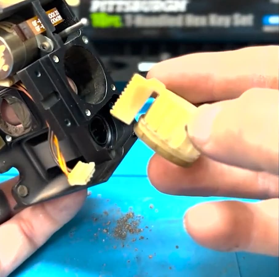

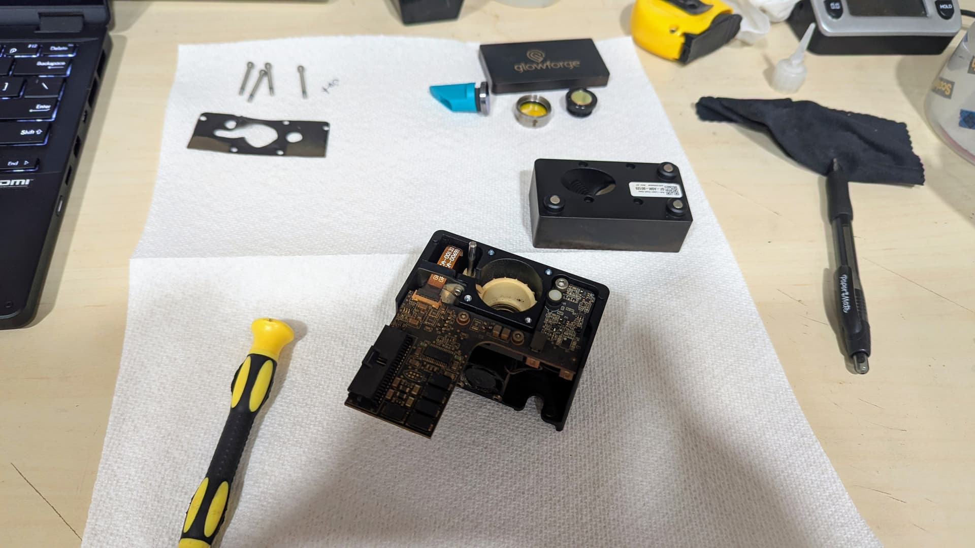

There’s not much going on in the print head. You might consider setting aside a half hour and either fixing or diagnosing it yourself, since you can put hands on it and remote tech support can’t.
There’s a little white cylinder of plastic with a ring shaped magnet that the lens clicks on to. A small motor moves this piece of plastic up and down in the head to change the focus height. With just a few screws, you can pop that piece of plastic out and inspect it. If it’s damaged, find a replacement print head to buy, from Glowforge or Wiregrass or eBay/Etsy. If it’s not damaged, you will probably see the gunk or debris or whatever is keeping the lens from clicking on. Here’s a photo from when I took apart mine to diagnose an issue:
This is the piece that holds the lens, with the magnet on the bottom.
Here’s a video that covers disassembling and reassembling the head:
Thank you! I took it apart following the directions, which were super helpful. The magnet case part itself is fine, albeit a little dirty. I got the magnet out, and it does seem to be the issue; it’s pretty weak. It was worse before I took it out of the plastic casing, and so I thought it was all just dirty, but the grip of the magnet by itself to the lens isn’t much better. I swapped the magnet from the casing with the one on the lens remover tool, and it seems to be holding the lens better now that everything is reassembled. I’m going to test it this afternoon and see how it goes! Fingers crossed it works again!
