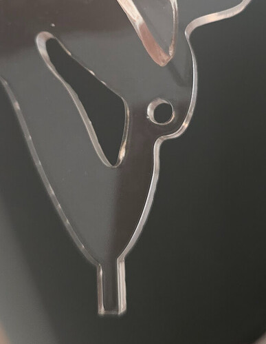

Glowforge (Pro) stops & goes into some kind of fail safe mode after cutting one step/object/section
My Glowforge seems to be working fine (perfectly cutting thick acrylic) but it always stops after one cut. The counter in the app keeps counting down but nothing else is happening and the head remains in the same position without firering. Canceling the job on in the app stops the fans but doesn’t move the head back home.
I’ve seen suggestions about adusting/cleaning the Glowforge & mirror but that’s clearely not related as it perfectly cuts the first part :
… and stops moving to the next (SVG attached).
What’s worse is that if I restart the Glowforge I can start the next section after which it stops again.

I there a reason you have such complex polygons vs. simple paths? The main outline has almost 1,500 nodes when converted to a path. I suspect that is playing a part in why it’s not printing succesfully.
I see it was created in Illustrator, perhaps someone can tell you how to covert it to paths.

Most of my designs are 3D (modelled in Blender) that are then converted to SVG, resulting in paths with a lot of points.
I doubt that this is the problem though as it has worked for years like that but you can see the outline cuts out perfectly but everything stops right after that.
Even if I print a simple 4 node square I’m getting the same result. There are other posts in the forum about this but they usually get closed after the typical "check/clean your mirror/vents nonsense reply :frowning:

It makes no difference : No matter what I throw at it (big or small, 1000s of points or just a couple) it just stops after one object. Here you can see it do a dual cut of one section and then it stops :
As you can see the cut is perfect so it’s not mirror (or whatever) related … :slight_smile:
… and the app doesn’t have a clue and keeps sending & counting down :slight_smile:
I can cut this piece perfectly … just have to do it one part at a time (big or small) so it seems to die switching from one part to the other.

I think the Glowforge does some kind of check in between objects, detects some kind of error and goes into failsafe mode.
I’ve taken it outside and blown it out completely with my air compressor to see if that helps but it’s exactly the same.
The only reason I remember the machine pausing as you say is when it overheats - and that’s generally not going to be perfectly times to stop after the first step.
Support can check the logs to see what the machine is doing, and check for error messages in them.

I’m doing the complete project in 30 minute steps now on a piece of proofgrade thick acrylic, that worked perfectly before as wou can see, cutting one step at the time.
Here I’m cutting (2 passes) the big outline, which works perfectly until it has to switch to the next step :
Here it is cutting a small circle. The cut is perfect but the machine goes into some kind of failsafe mode and has to be turned off for 20-30 minutes before it’ll power on again :
Here I’m cutting the 2nd small circle :
… after which it goes into some kind of failsafe again.
Here are the next steps, each time turning off the machine for 30 minutes :
So after 3 days of cutting, each time restaring the machine after 30 minutes we managed to perfectly cuts this part out of thick acrylic :
