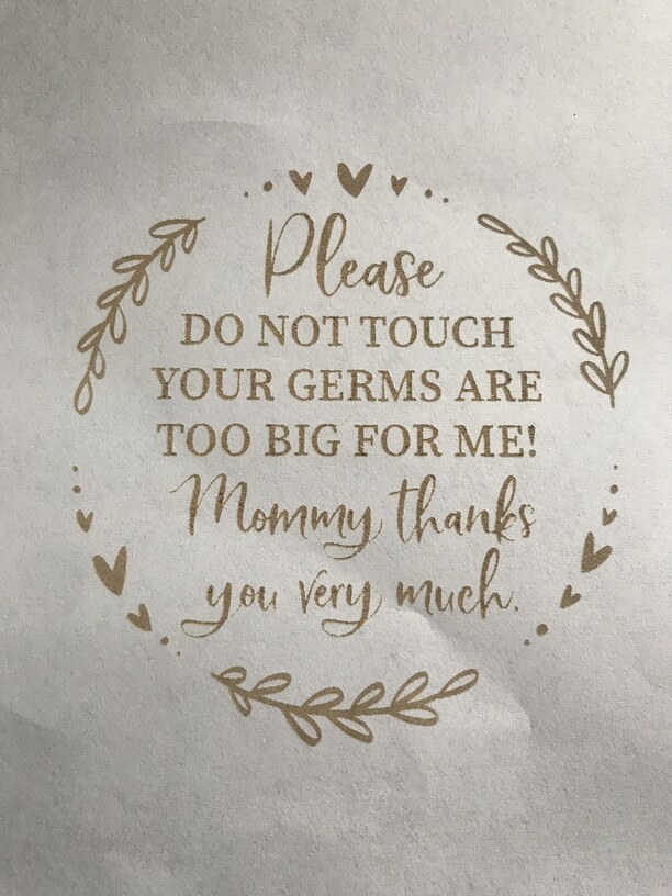

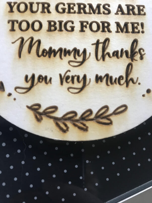

I have had perfect results when engraving this image on the wood and then the next time I recreate it, it will be jagged like the first picture (bottom vine detail)
It almost looks like there is a difference in the quality of the wood. What are you trying to cut/engrave in the photo?
This is when it is engraving perfectly, the other picture was when I had tried it on paper. I am trying to engrave on 1/8" baltic birch plywood. I have been doing 850 speed with full power. Lets say I have 3 to make. Sometimes all 3 will engrave perfectly and then sometimes I can try 5 times to get one too look good. Its so hit or miss and I’ve wasted a lot of material trying to figure out why.

I’d lose the magnets. You want to keep them well away from the head when it is moving.
And the second to last one there looks like what happens when the tension on the belt under the laser arm is either loose, or it hit something. Not much of an effect, so it might just be the magnets.

I’m so sorry to hear that you’re running into trouble. I appreciate you providing so many great examples.
As @Jules pointed out, the location of the magnet may be causing unwanted behavior while printing. I noticed that you are utilizing Manual settings for this print on Proofgrade material. Does the same trouble occur if you use Default Settings on Proofgrade Material for the same design?
