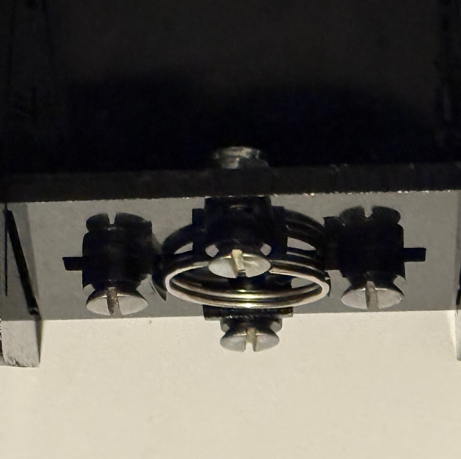

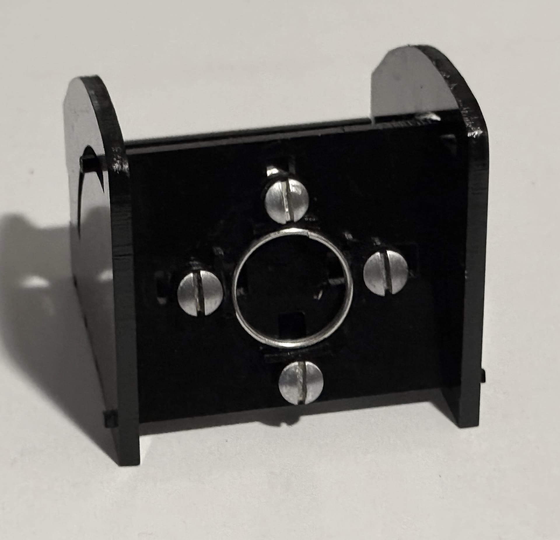

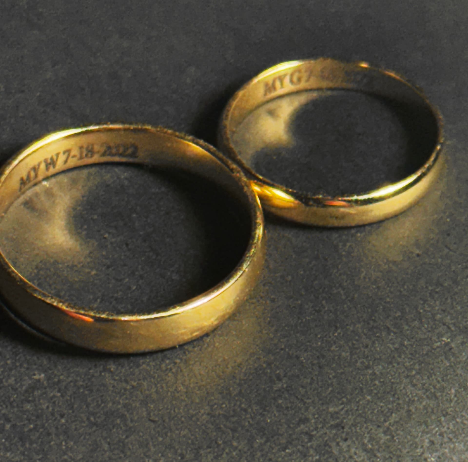

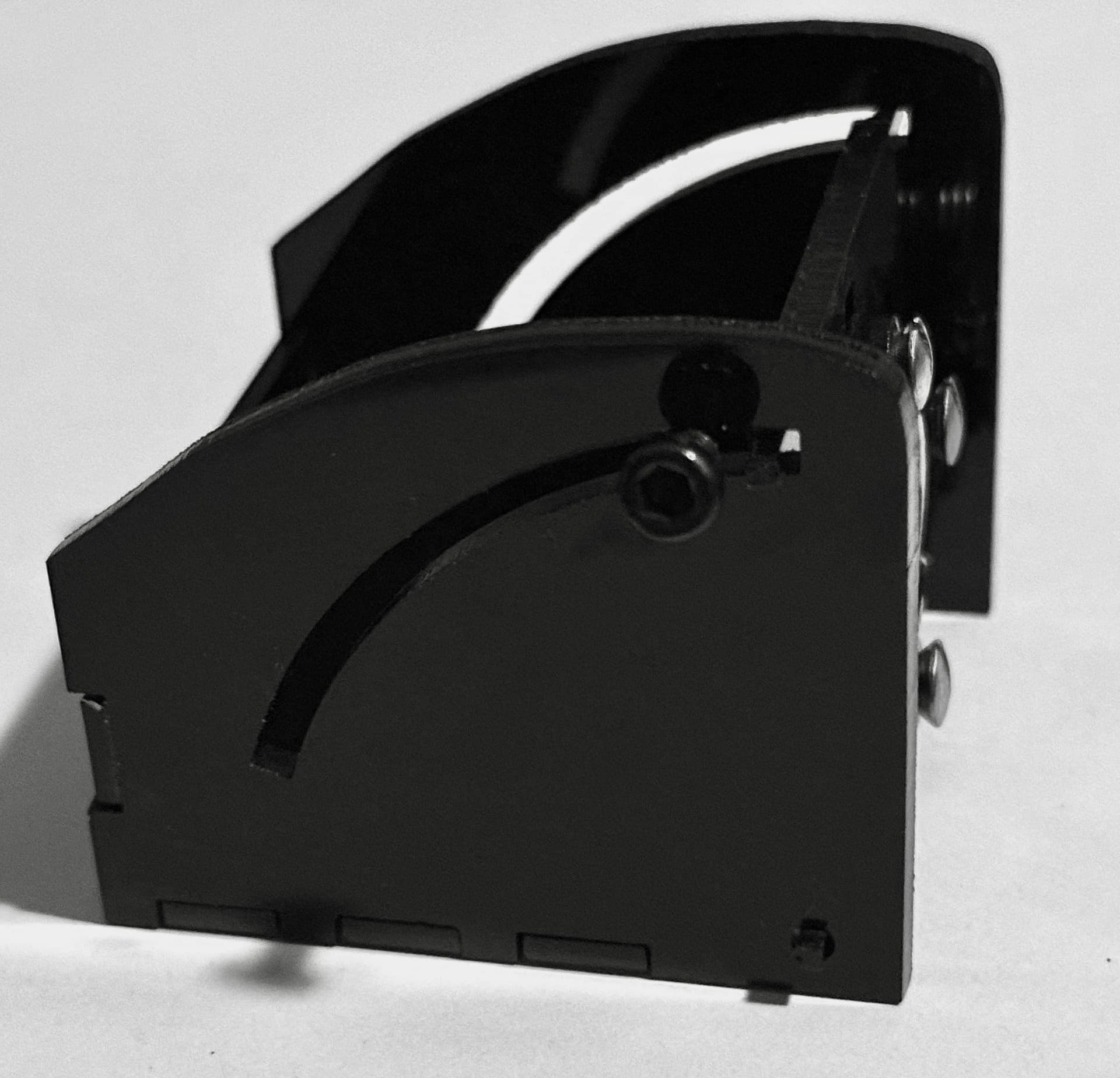

I needed to engrave the inside of some rings but there’s no ring or rotary attachment for Glowforge :upside_down_face: . So I created something quick and functional to help me get the angle I needed. Metal marking spray for the rings makes it show up great.

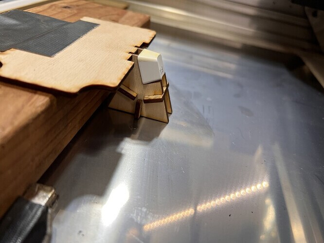

That’s pretty cool. I made a weird jig for engraving key caps, you might find it interesting:
Details here:

Ooo, that is really neat! I love the adjustable angle for the jig. They say a 21 degree angle is ideal. You could mark that angle on the side for quick setup.
