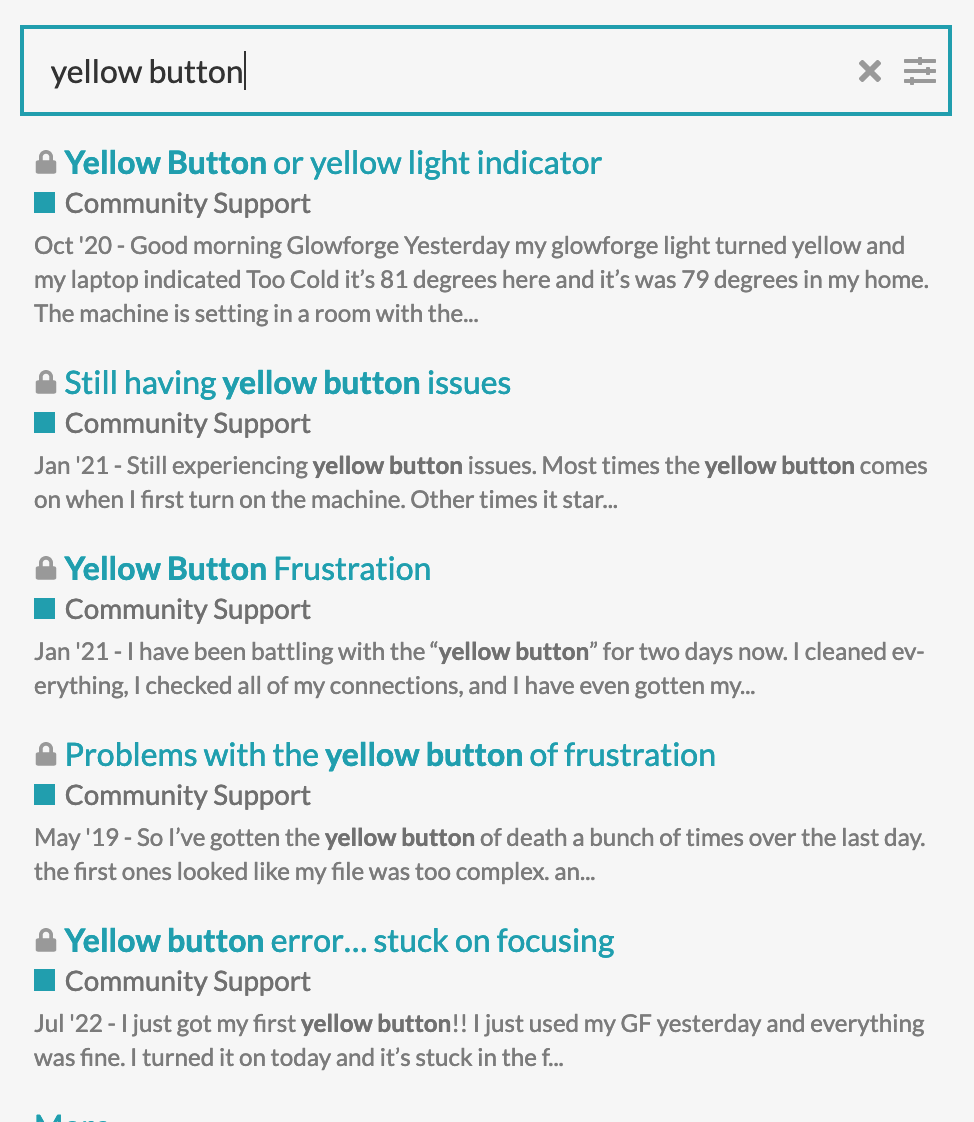

Try a search in the meantime…and I’m betting those more knowledgeable will chime in with some suggestions. Best of luck
I would try to print the gift of good measure just to be sure.
Yellow generally means that the laser has lost connection with the head. If it’s too cold in the room that can cause it - or a loose connection - or broken wire.
Temp is easy to check, for the rest you’re going to want to start at the head and make sure the connections are tight, and inspect for bends/breaks anywhere in the cable.
