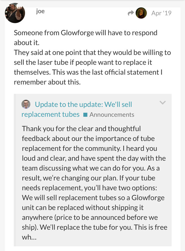

Does anyone know if anything came of this?
My first guess would be that after a 10 hour engrave your machine needs a cleaning, but you said you’d done that.
Even running 8 hours a day 365 days a year, you’re still barely at 3k hours on your machine and they are expected to last close to 10k (unless your hobby usage in the year before was WAY more than your current usage)
That being said they have been unable, so far, to send a tube home. They are still offering the $500 for replacement and shipping that they promised up front, but AFAIK only a few people have had to take them up on it.
