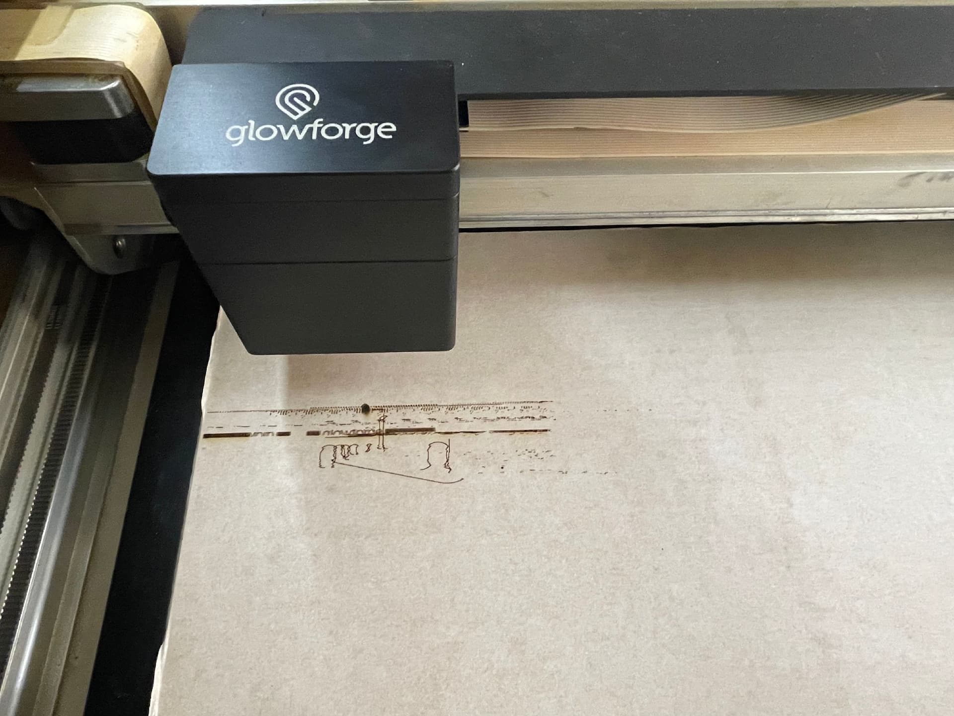

When that happened, and tried to run a test print, left / right movement was way off - too far or not far enough, and needed to stop the print in order to prevent a fire from laser cutting without L/R movement.
Support told me I needed a new carriage plate because the wheels were missing bumpers (even though I was mostly sure that original did not have the “bumpers” (and there were no parts in the bed, and it worked fine last time) - but I went ahead and ordered the carriage plate - which resulted in no change - same issues.
When the white and black ribbon cables arrived, I tried the white cable first, and it did not resolve the issue. Did the black one, and also no change. One support person told me I needed to run the printer head setup (but I declined - given the issues with left/right movement and the fact that it might create a fire, whcih I suspected given the Gift of Good Measure test print I did AFTER the new cables were installed (with Support on the phone).
If you see the heavy burn dot under the printhead, that’s where it was burning without motion - just like the first time I tried it. This time was after all of the replaced parts (white and black ribbon cables and the brand new carriage plate.)

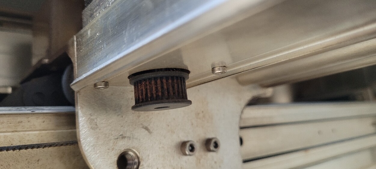

I’m really hoping to resuscitate the machine since this seems like only a L/R movement issue. I have not replaced the Pulley wheel(s) - but wonder if this could be the issue. When I took pictures, the GF Support Team did not suggest this might be the issue.

Normally, if left/right movement is off then recalibration is where to go, but not moving at all is either the drive belt or the drive pulleys. Since you just replaced the belt, the gantry pullys might be the issue. The belt also can mess up by being too tight or too loose.
With the machine, and belt off, you could try to feel if working the pullys with your fingers to check for wobble or rough turning.

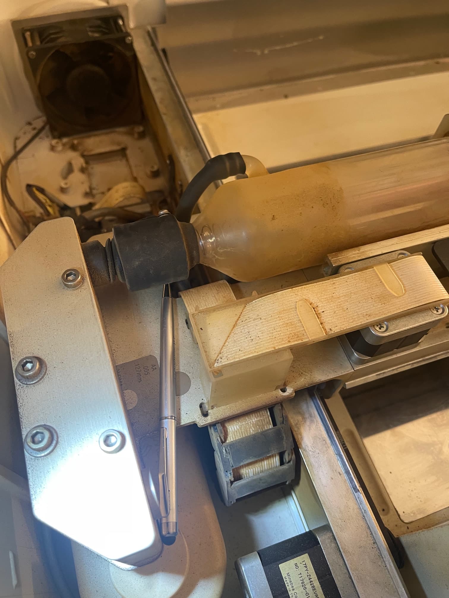

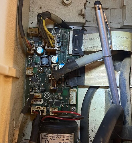

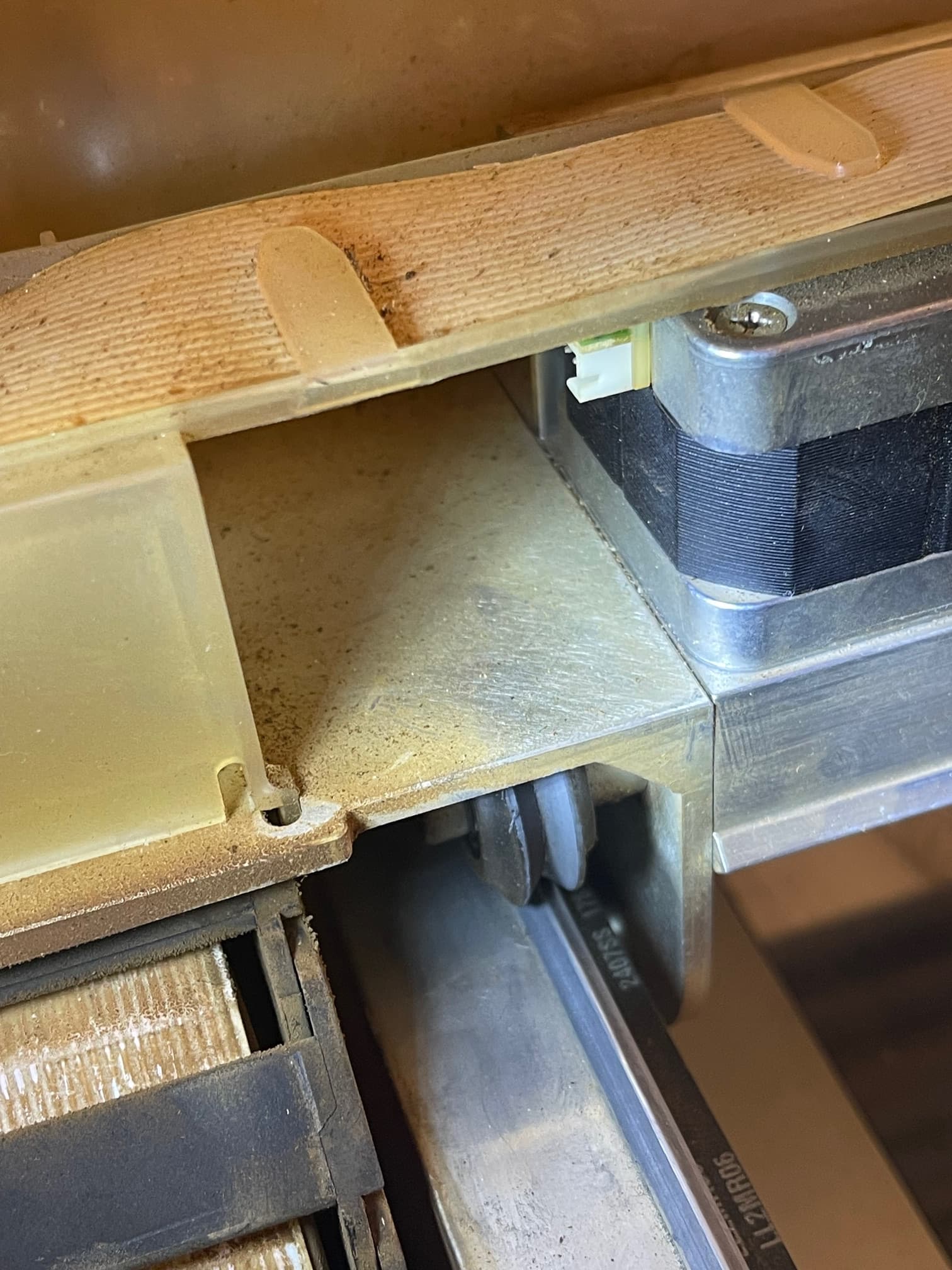

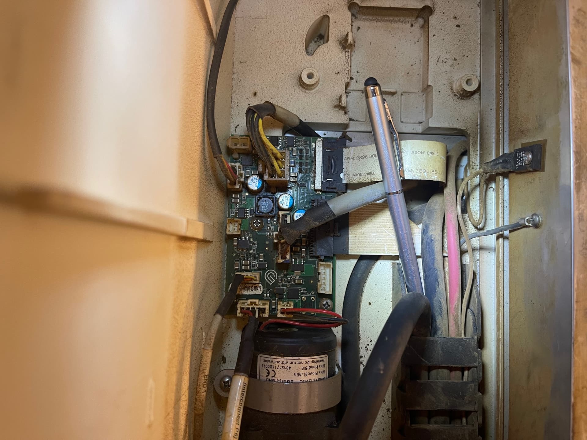

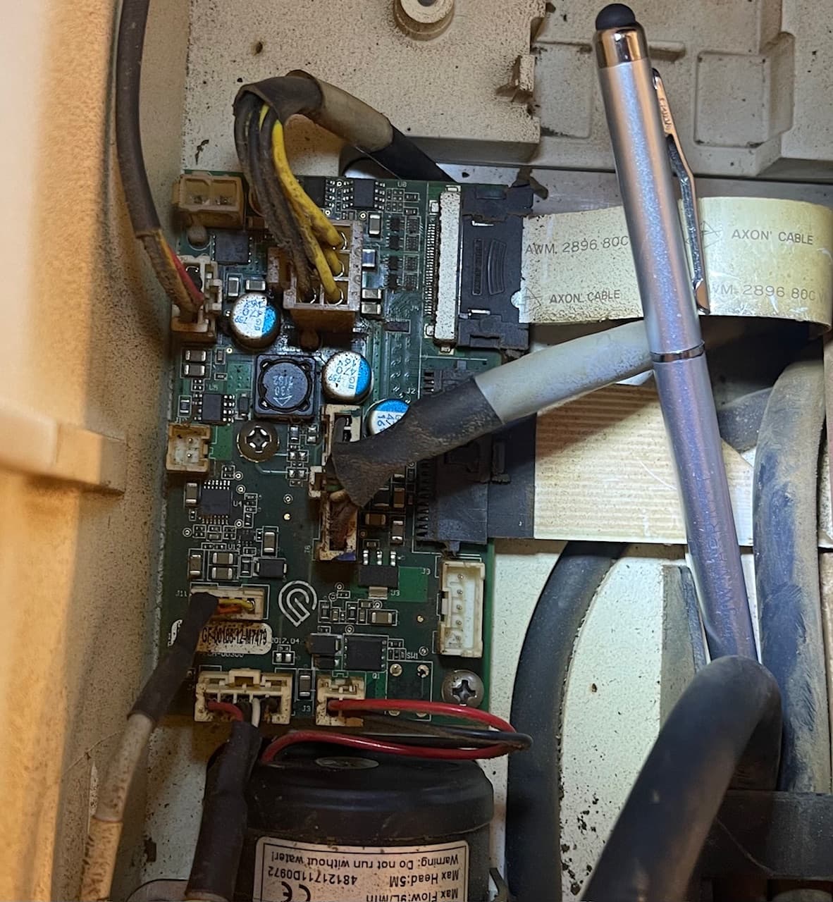

OK. Here are the pics, and an explanaton of what has to be done to fix (replace) the x-axis wire.
Note that I don’t have the “before” pictures, but the instructions are to pull the existing wire (either from bottom to top, or top-to-bottom) through the “serpentine belt” (im sure that’s not the right name for it - but that’s what I’ll call it. and to either attache the new cable to the old one, or attach a string , wire, etc, so you can then pull the new cable through.
Because there are a number of other wires / cables, its a REALLY tight fit - and I didn;t realize just how challenging it would be.
I have used a pen in the pictures to try to show the path that the cable / wire follows.
It plugs into the PCB board where the open white spot is at the right side of the pictured board and then follows the path indicated by the pen.
Thenit follows the pen’s path INTO the belt (which moves as the gantry goes front to back / back to front
The wire then has to go through the entire serpintine belt, up the “u” bend so it then faces toward the back, and come OUT of the belt.
Once it exits the belt, you then wrap it under the tube (from the hole) and it goes where the pen it, and then under the "bridge holding up the (wide) white ribbon cable that goes to the stepper motor (the silver metal block at the right of the third picture.
Then, it connects to the stepper motor where the white connector is show in photo #4.
The first and last steps are easy. I did not realize I was going to have to run it / pull it / etc. through the serpentine belt, When I was pulling the existing cable thhrough, i was not able to get the old +new cables through (hooked together with masking / painters tape), so I decided to use speaker wire to attach to the old cable, and successfully pulled that through to use as a “fish tape” to pull the replacement wire through. Problem was, the run through the serpentire belt was so tight that the speaker wire itself broke.
And because there are several other key wires in the belt, I do not want to risk breaking those or potentially doing something to create a short.
So that’s why I think Geordi the Forge is done.
Any thoughts?

OK, here are my initial thoughts. I can’t easily fiddle with mine right now, for multiple reasons otherwise I’d pop my cover off and check. Perhaps someone else who’s had theirs off could..
I am pretty sure from memory that by moving the gantry forwards and back, the bend in that conduit could be moved around to ease the tension on that connector for the cable in question, to allow you to not only pull it back out, but also get a better “fish wire” option in-place. It’ll be fiddly, but I’d personally take spending time fiddling with something over spending lots of $$ when everything else about the machine is likely good.

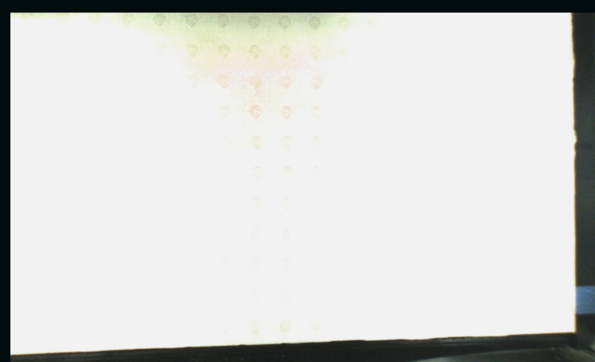

While the original issue is resolved - and we home, center, and cut, the picture is now skewed and the bed is SUPER bright.
(Gift of Good measure runs fine, and the calibration printing ran fine too).
I tried running calibrationa and it completed, but said there was an error, and then also a message that stated that no improvements were possible.
I’m wondering if there is an incompatibilitiy between the PLUS motherboard that was swapped and my BASIC machine.
Bed Image As Captured from the UI (with no lights on near the forge)

I can’t say with certainty or experience, but I can not imagine a scenario where there is a motherboard hardware difference between the different models.
I would expect this is something they could fix with some kind of remote “firmware” push..
well, I spent an hour with Tier 2 support and they said there is nothing they can do from a “back end” configuration perspective. I have also discovered that Set Focus doesn’t work - all likely tied to the same issue (my guess, not theirs). Additionally, they DID agree that the LEDs are too bright - and the image is very washed out - unless I wait to take a picture / refresh once the LEDs naturally dim.
Upon my asking about the Black Lid cable (which I did replace as part of the original troubleshooting before the MB swap) - they said that COULD be an issue / cause, and so they (Glowforge Support) are sending a new black lid cable for me to try. I did save the OLD (original black lid cable, and will try that before the new one gets here, as an interim trouble-shooting step.)
The saga continues… but I still feel better than I did two days ago.
Thin masking tape? Just to dim the light a bit.
