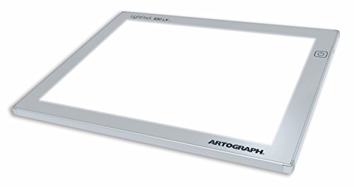

Was in Michaels today and the wife noticed some cheap laser cut chipboard owls. (Less than a buck) Asked me whether I could recreate the same in Proofgrade maple, with a key ring hole. Sure, no prob.
Put the original piece on a small Lightpad (almost any diffused light source will work).
The owl on the left is with the light off. The pic on the right shows a very well defined silhouette. Take a picture and import into Inkscape.
Easy Peasy from there to convert for the Glowforge. Couple minutes.

Do you happen to have a link to that light board you used?
You can see them on amazon:

You can get a LOT cheaper light pads. Just happened to have this one because my wife uses it everyday for her draft artwork. Great for tracing, silhouettes, looking at negatives, etc. Even cool to better see any kerf effect in laser cuts.
yeah i imagine if you’re handy it would also be pretty easy to whip up a little box, some led strips, and a piece of frosted acrylic…
A tablet or cell phone with a white background displayed should work fine too

gorgeous! Instead of the lightbox, could you have placed the chip-board owl directly into the GF and have the camera trace it directly into the software? Or, would that have been not enough contrast?
It might have done an okay job, but you’d probably be left with an outline. Plus, this way you can modify / resize easily!
inspiration - no idea if this would work, but a really cheap light pad would be a laptop / tablet screen with a blank text document (or Word or Inkscape or whatever) showing… I’ll have to give that a try tonight.
No. My experience is that would not work out well. The trace function is not set for that level of detail.
