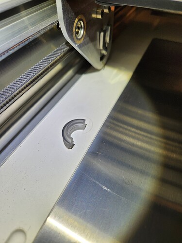

So after finishing a print, I noticed that there was half a wheel lying in the bottom of my machine. :flushed: The laser worked fine for its print, didn’t seem affected at all, but now I’m concerned as I’m not sure that wheel can be replaced?? And I have Etsy orders I need to get out. :grimacing: Thoughts? Anyone else have this happen?
you can order those wheels last I heard, however, dunno about availability.
They sell carriage plate wheels, and I think they are all the same, but a phone call could confirm…
The support folks said that they don’t even sell that wheel, so I’m assuming it must be slightly different. They also couldn’t provide any guidance as to how to replace the wheel even if I could get one. They said to look through the forums…not super helpful unfortunately. But they did say that wheel isn’t all that important and that the machine should function fine without it…I sure hope they’re right… :grimacing:
