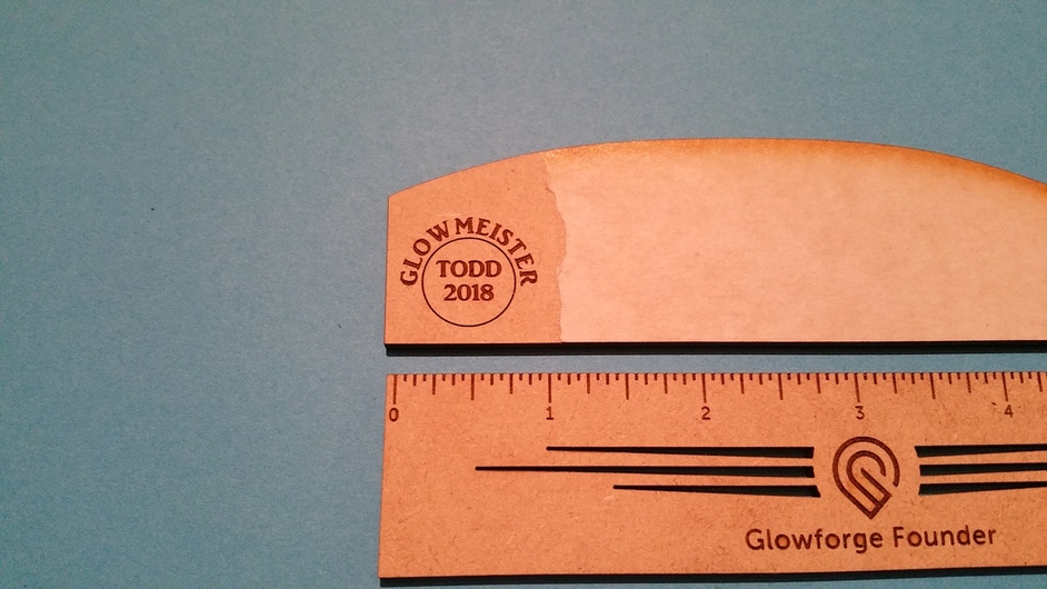

Wanted to mark our items with a date … came up with this. Glowmeister is the name of our Glowforge. Here is the test on Medium Draftboard.
Again, I’m using Silhouette Cameo Designer software, saving it as a .studio3 file, and then converting it to an .svg file for the Glowforge.

Looks like a great date! :grinning:

What a great idea! So far I haven’t been signing my pieces, but that really needs to change. I ought to design a personal logo.
