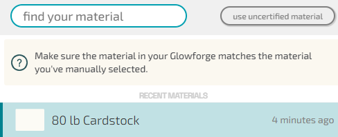

Does anyone have any experience cutting or engraving mat board? If someone does have some experience, can you share with me the settings you use to cut the mat board. Thank you in advance.
Matboard is a brand name. Lasers were not a thing when I last used it, so you will probably have to run a bunch of tests. It is very similar to cardboard so this might be a good starting point…
80lb card stock
