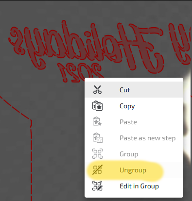

I’m need to change the date (it says 2021) on the Edge-lit layered Holiday Snow Globe in the catalog. Is it possible, and if it is, how?
Select the design, and then either right click and select “Ungroup” or hit Ctl-Shift-G.
Once it’s ungrouped, you can remove the date and replace it using the text tool (if you have Premium) or by uploading a new date file using the giant + at the top of the GFUI.
Thank you very much. Pretty much was staring me in the face.
