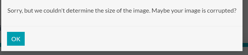

It won’t let me upload says it can’t determine the size of my photo.
this is the message I get when I try to upload the file
