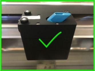

The mirror handle should look like this:
It should NOT look like any of the below:

Yeah that’s what I meant
