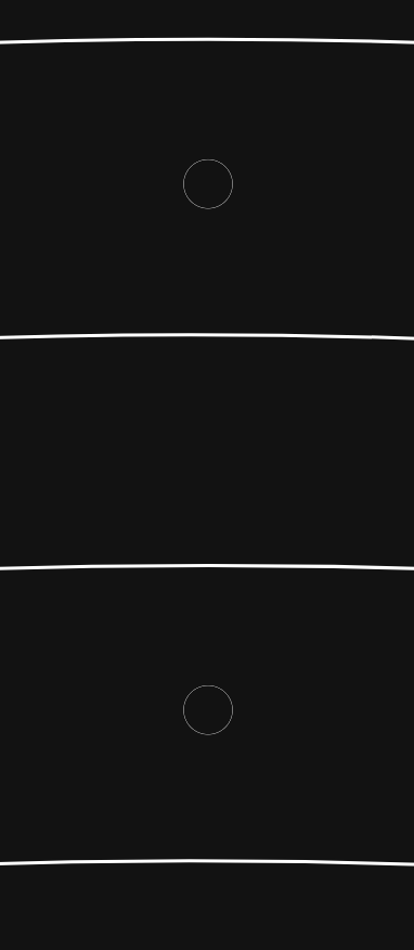

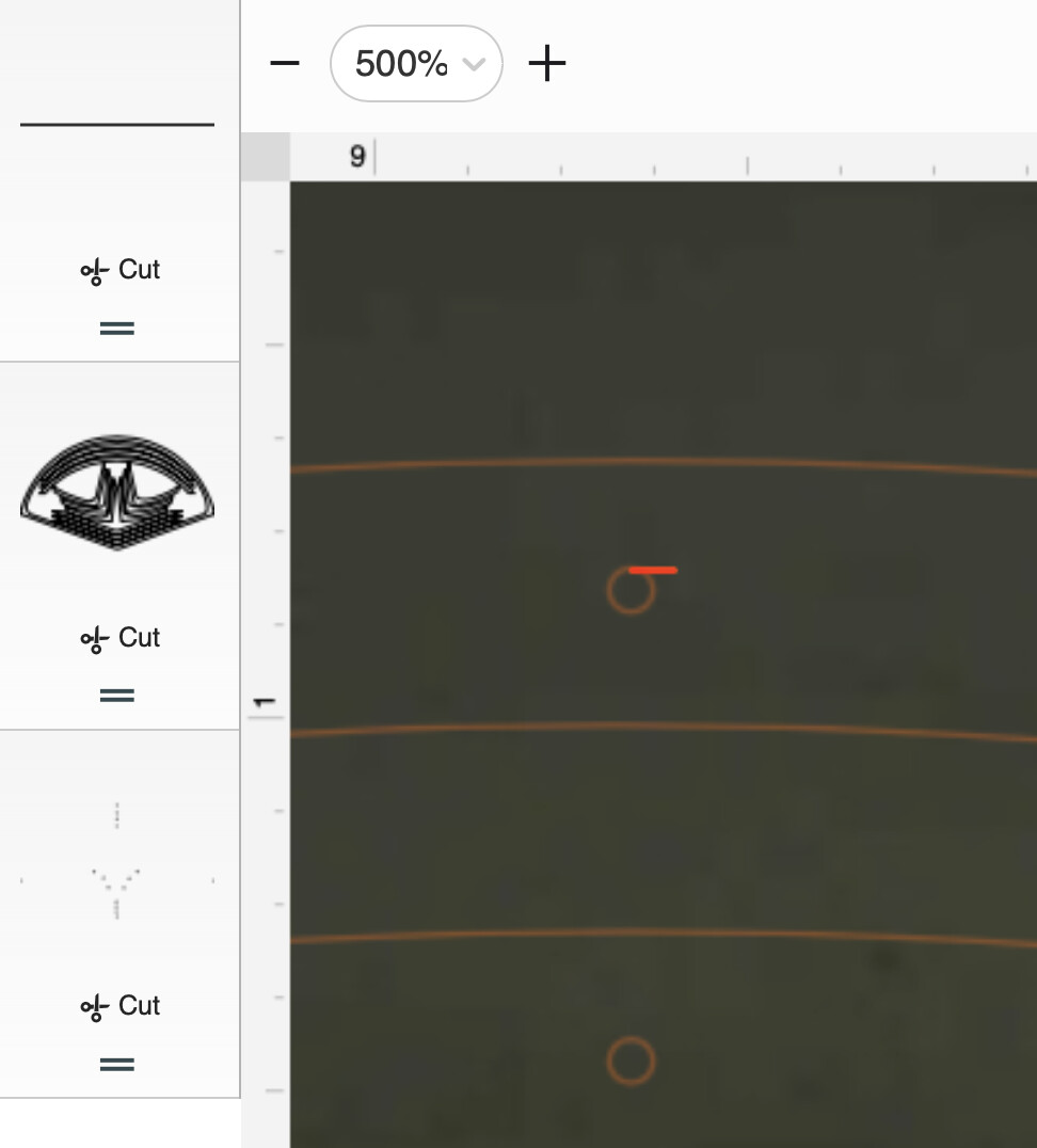

So there are two odd objects right on top of the very top/center hole/circle. Horizontal lines.
I was able to get the design to open in the UI by copying the elements into a new blank document, then I spotted them as I had made the main shapes and holes/circles different colors - so those lines showed as a separate step.
You can see them in my version below, just peeking out as a different color. I can not get them to show in inkscape, however, and they do not show in the you design displayed above.

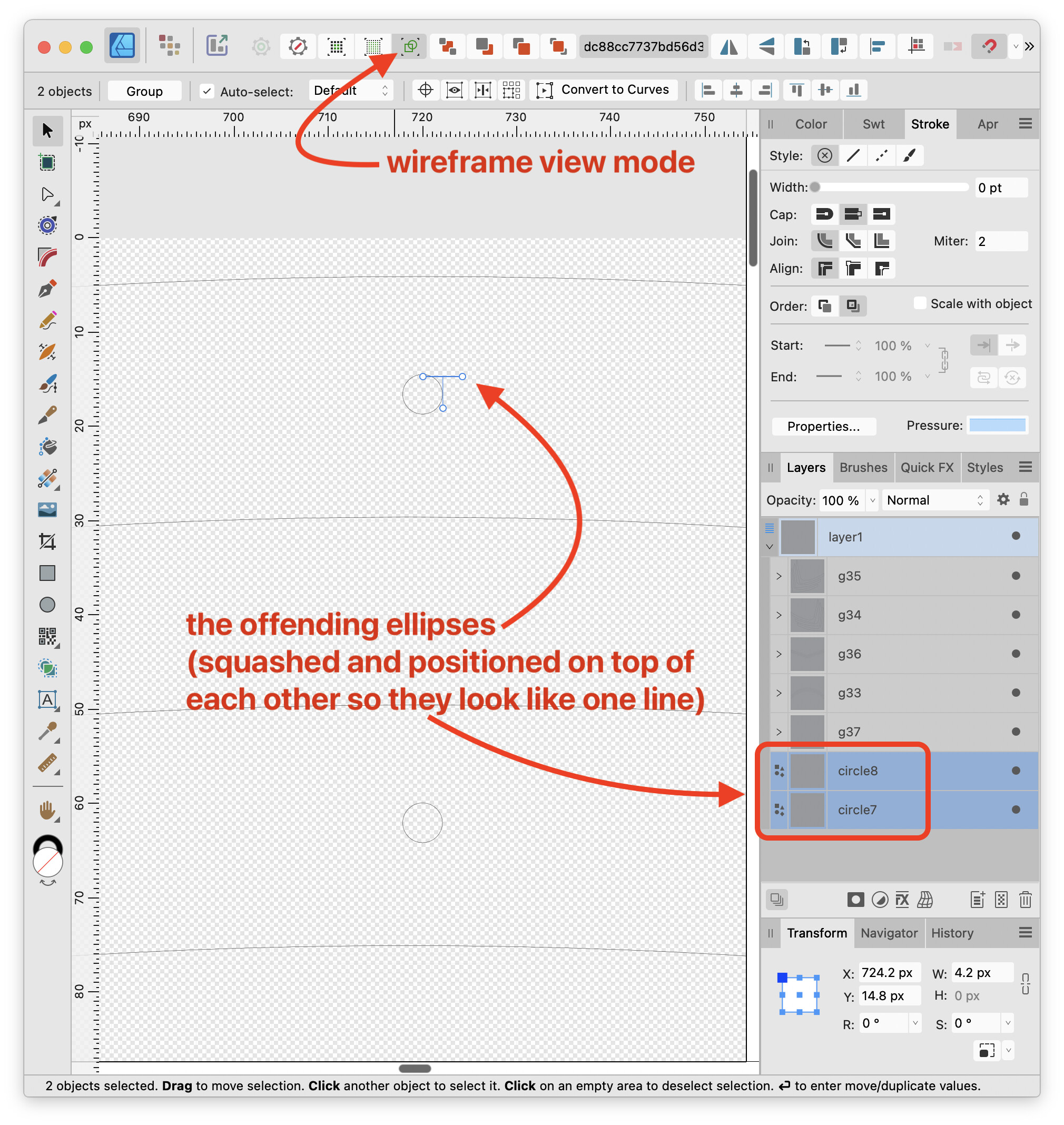

I can see them in Affinity Designer by putting it in “wireframe view mode” which ignores all of the strokes/fills specified in the file and just shows everything with a thin black stroke and no fill:
The two objects are named circle7 and circle8 and looking at the SVG in a text editor, I can see that they are actually ellipses rather than lines:
    <ellipse style="fill:none;stroke:#000000;stroke-width:0.00000000111156" id="circle7" cx="-254.75" cy="5.2041669" rx="0.74503553" ry="9.3376675e-15" transform="scale(-1,1)"/>
    <ellipse style="fill:none;stroke:#000000;stroke-width:0.00000000111156" id="circle8" cx="-254.75" cy="5.2041669" rx="0.74503553" ry="9.3376675e-15" transform="scale(-1,1)"/>
Notice that ry (the y-radius, or half the height) is set to a number very close to 0 (specifically 9.3376675×10-15) which is why it looks like a line.
I don’t see anything that should be causing errors, but it’s possible that the Glowforge UI can’t handle that scaling factor. (It might be rounding it to zero, then getting a divide-by-zero error, for example.)

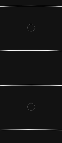

Here’s the file with the offending ellipses removed (I simply deleted those two <ellipse> tags using a text editor) which loads into the UI just fine:
fixed
I tried that, manually deleting those two ellipses in a text editor, and it did not work. Probably missed a delimeter..
They don’t show in the original file at all, in any view mode. Very weird..
