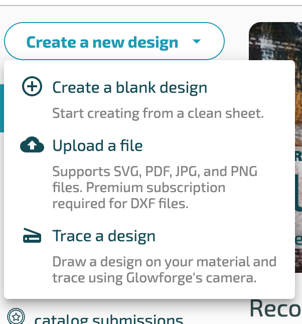

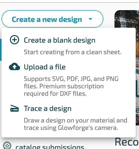

It’s also possible to ‘trace’ (bottom option) what you’ve already made and add a cut line to it.
