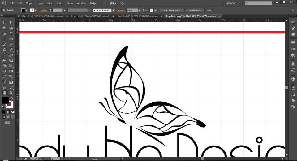

I’m preparing my very first design upload. I use Illustrator I just realised that designing for a laser is completely different designing for illustration prints and cutting decals. I’m starting with s simple keychain with my logo. I created a SVG at 300dpi. The keychain is intended to be 1 x 2.5 inches.
I read @Jules laser design basics and got the idea that we always had to use rasters for things I want and use paths to cut. I placed the logo as embedded PNG and surprised how pixated the logo is:

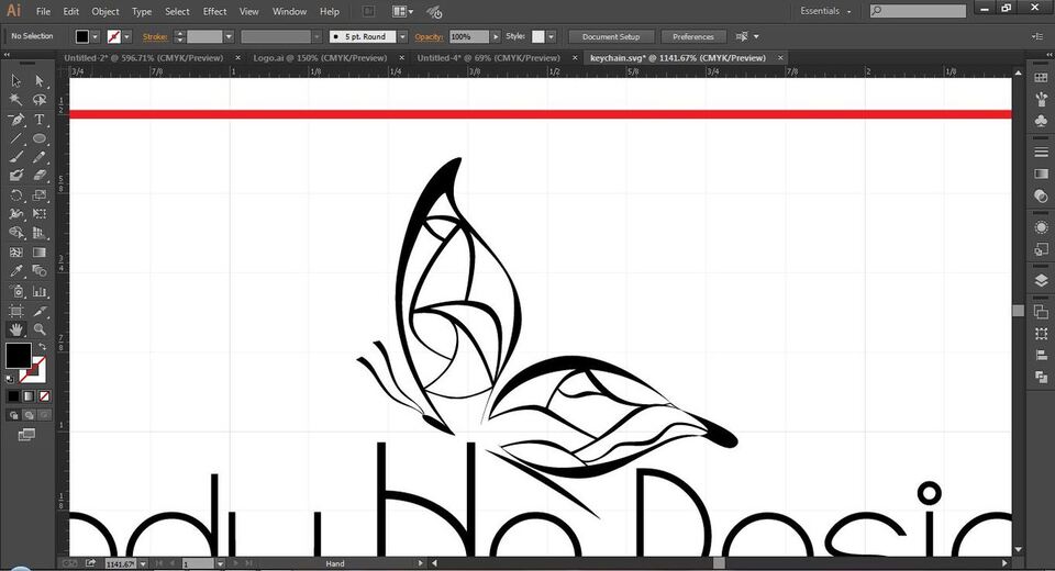

So read the tutorial again and @Jules didn’t say we had to use rasters to engrave, just said rasters are always engraved (whoops). So, I was quite happy to learn we can use a vector fill:

Yes, you can definitely engrave vector fills, and they generally give better results than rasters. (You’re zooming down the track!) :grinning:
The one time we need to use rasters is for gradients - the Glowforge interface can’t handle gradient vector fill yet.
#3
My rule of thumb is to always do vector when doing my own design work.
The only time I’ll voluntarily use a raster is as you point out, a photo, and sometimes for a little something I’ve lifted if it is going to as small or smaller than the original.

Rasters are simpler: it’s just a grid of pixels, and what you see is what you get. If you hand the Glowforge a vector to engrave, it has to rasterize it, which means the software in the Cloud is doing all of the strokes and fills and such to ultimately produce a bitmap for the engraving pipeline. Sometimes that causes more trouble than if you just rasterize it first in your drawing program. Here are some of the reasons you might choose to convert to raster:
  • Vector file is too complex for the Glowforge UI (processing takes a long time or fails)
  • Vector file uses unsupported features (clip masks, gradients, etc.)
  • Vector file has design glitches like overlapping paths, white knockouts, etc. that are more trouble than they’re worth to fix
On the other hand, if you just have a simple black and white drawing that’s already in vector format, you should probably leave it that way because it’s more flexible. You can resize and rotate it in the GFUI, and don’t have to worry about introducing pixelation if you use too low a DPI.

You’re off to a great start!
Illustrator to laser is actually a lot like Illustrator to cutting decals, especially “printed and cut” decals with combined vector & photo. :smiley: As @chris1 mentioned avoid unsupported features like masks and gradients. If you ctrl/cmd Y for wireframe view - that’s what the laser will see of your vector art. Much like a vinyl cutter.
#13
I have a few friends who does animation and it can take a long time to render. I sub-consciously applied that thought to vectors since its using the cloud. That butterfly was originally about 100 paths. I spent 20 closing paths and outling it. It was the first thing I drew and never bothered to fix it until since it’d look the same on paper. Glowforge is forcing me to improve skills
