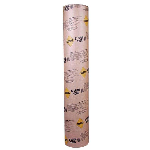

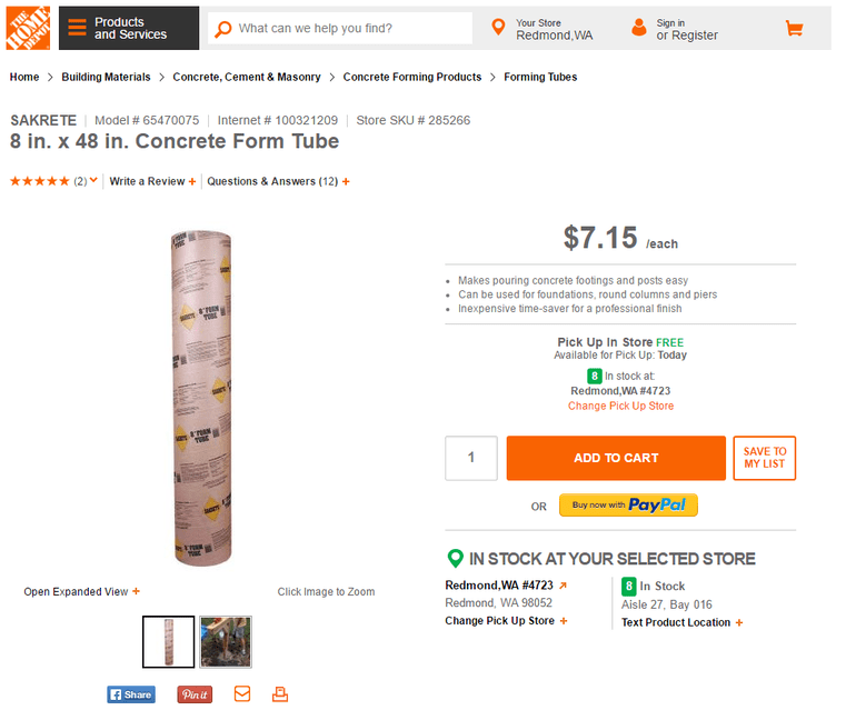

A long time ago (in what feels like a galaxy far far away), my high school buddy built an Newtonian reflector using a concrete form tube from Home Depot as the main tube, spray painted matt black:
http://www.homedepot.com/p/SAKRETE-8-in-x-48-in-Concrete-Form-Tube-65470075/100321209
