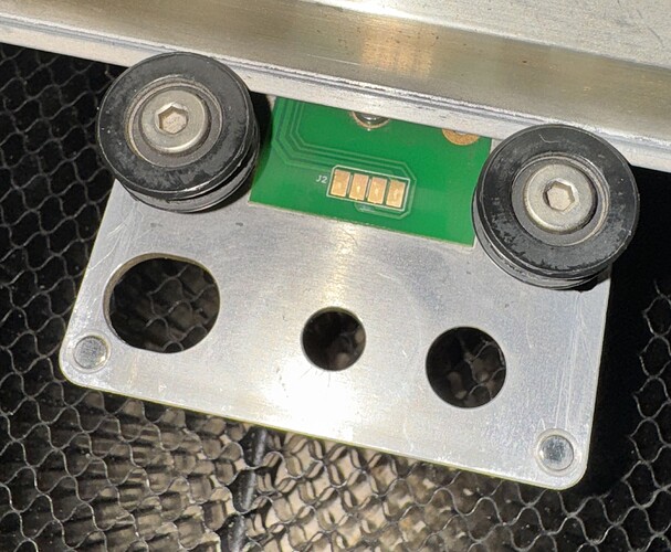

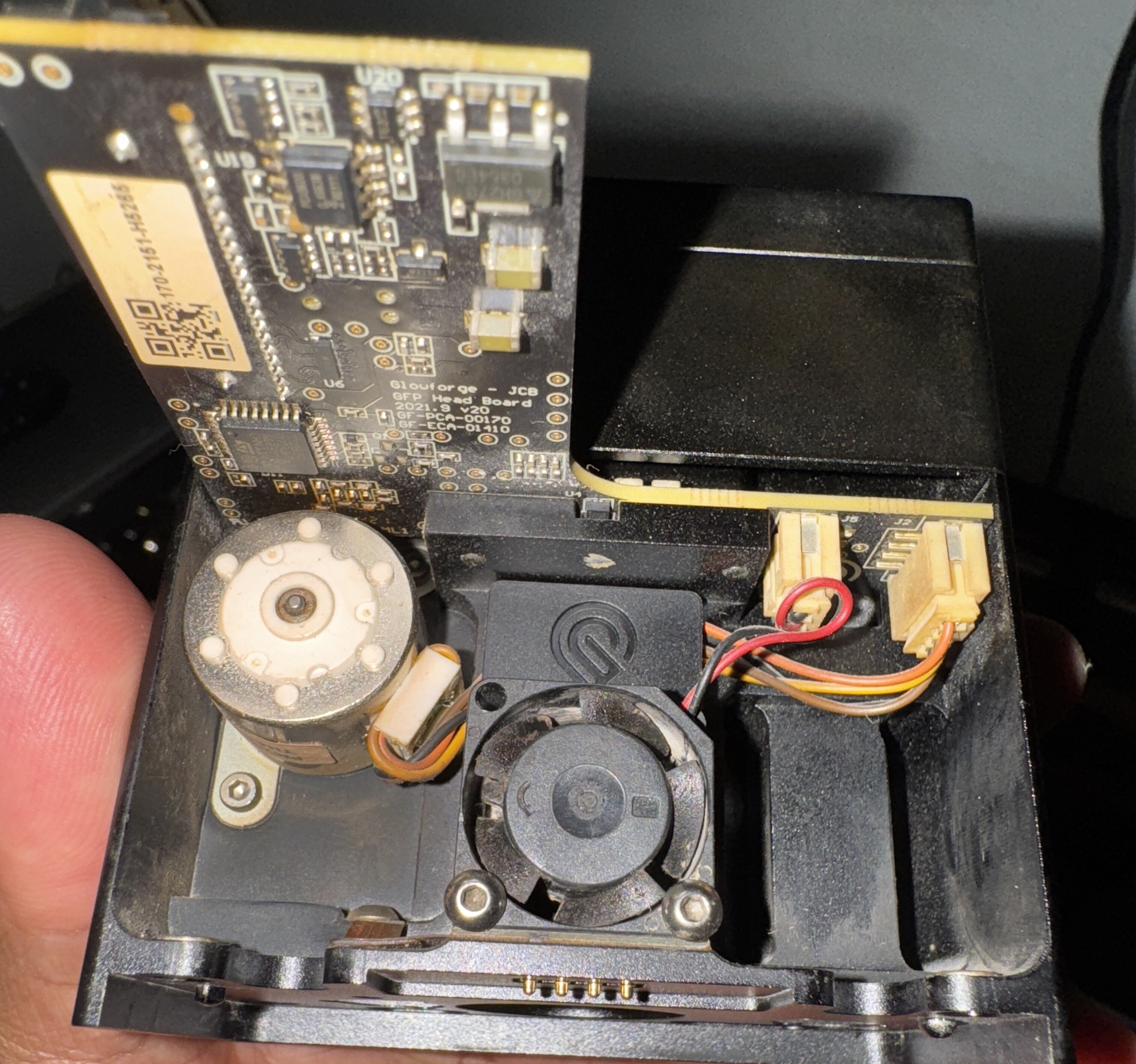

Someone posted about this issue in the past and now I’m having the same issue (mostly their past post below). My laser head is not being found, has anyone found a solution?
I have done the following:
  • Cleaned Air Assist Fan
  • Checked wheels on AAF
  • Cleaned all rails of the gantry
  • reseated all connections
  • Cleaned cameras
When I turn it on from the default position all the way back and to the left, it makes a grinding noise during calibration because it is trying to move to the left ONLY. If I turn it on with the gantry in the middle and the GF logo under the camera it sits and tries to home/center/focus for what feels like eternity and then errors out saying Head Not Found.
By chance does anyone have any further advice?

Be sure the glowForge is empty. Sometimes having materials on the machine at startup can confuse the camera.
Also clean the contacts on the gantry and the pins on your head.
Update: I checked the camera on the lid and it’s not loose. I also took of the “head” and cleaned the 4 pins and wiped the area down. Unfortunately, I’m still getting the error. :disappointed:

Thank you all for the helpful feedback while I worked on troubleshooting my machine. I ended up reaching out to Wiregrass, shared a few photos, and they quickly identified that I had installed the belt incorrectly. After correcting it, the error is now gone. Big thanks to Wiregrass for their excellent support—I highly recommend their service!
