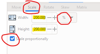

Hi! BIG NEWBIE here… I am trying to make a nursery room name sign. I got it to cut out small. But want it to be bigger. I have the glowforge pro and use Inkscape to create. Any tips or tricks for a newbie. I feel like I am going about this the hard way. Also, what is the best material to use for a name sign?? Thanks in advance.
Should edit to say… I figured out how to create the name in inkscape but I am struggling with making it bigger and the glowforge recognizing the file.
I’m not an Inkscape user, but I’m pretty sure there is a scale command in there. But you don’t even need to bother with it. Just save your file as a pdf (that way the text gets converted to outlines automatically in your export), open the pdf in Glowforge, and scale it there.

In Inkscape it’s under Object > Transform (or Shift+Control+M) that’ll get you a menu that offers a bunch of options. Scale, percentage, and Scale proportionally are the ones you want:
