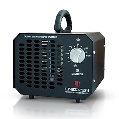

I found a solution to a problem I was having, that people may be interested in. I have a whole pile of cardstock cat stickers that I cut out using the Glowforge, and was in the process of coloring them in when I had to stop. The strong odor of burned paper was making my eyes water and giving me a headache.
So I remembered a small appliance we bought a while ago for mold odor remediation, but never used: a small ozonator. We never worked up the nerve to run it in the house due to all the dire warnings about it that we read in various places, but it’s perfect for this application.
I just put it in the bottom of an empty kitty litter bin (we have lots of those!), put a small grate on top, dumped the cut paper cats on top, set the timer, and put the whole thing outside & plugged it in. After 40 minutes I checked it and there was no smoke odor at all. Problem solved!

Yeah, this particular application is the only one I’ll ever use the unit for, and only outdoors. And I didn’t close the lid of the container more than halfway, to avoid overheating.
This is nice. I’m honestly not sure how much the kitty litter is doing vis a vis odor removal, beyond your other measures, tho. If you or someone else wanted to try something indoors, you could probably replace the kitty litter with the activated charcoal you can buy for aquaria and a fan for the ozonator.
