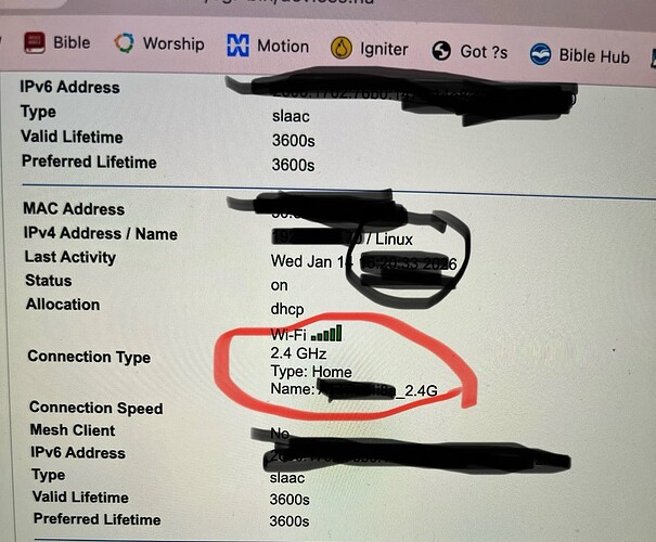

My machine has been stuck in aligning print since 12/31/25 while using the passthrough. Glowforge persistently states that my internet connection is unstable which is not true. I have executed every troubleshooting options they have from hard resetting to unplug the router to connecting to my personal hotspot to connecting to a separate extender. None of these options is working and their most recent reply is to contact a repair service. I hate that I purchased this machine! Glowforge won’t take responsibility for their failed app, software, or cloud. Although it is out of warranty, they can see that I have barely used the machine so it hasn’t been abused or overloaded. The camera doesn’t move when I turn it on. The camera doesn’t refocus. The fan doesn’t even come on. I’m so frustrated with this issue. Anyone else experience this and have a solution other than my internet connection.

I have moved my printer directly next to my router (AT&T) and it doesn’t clear the Aligning Print issue. I separated the bands between 5ghz & 2.4ghz so that I can connect directly to 2.4ggz. According to my ISP, there is a strong connection. Linux is Glowforge

I have run those tests several times with Glowforge support on the phone walking me through every troubleshooting option. I have even sent them videos of my executing the steps and nothing changed. So if I say, “I did that” in this group, it should be sufficient. I have executed every option repeatedly, ad nauseam with Glowforge Support walking me through each step as well as doing them on my own. Your presumption about my reply is incorrect. Glowforge and no one else can tell me it’s my WiFi when I literally moved my printer 6” from my router and my connection report from my ISP indicates that there is a strong signal.
I’m looking for a solution that maybe someone has discovered that isn’t one that I have tried already 20+ times each since 12/31/25. I’m not trying to be harsh just exasperated with the entire situation and don’t feel that I have to elaborate any further than “I did that” or “I tried that” especially when none of the suggestions from Glowforge or anyone else has resolved the stuck aligning print status. Glowforge knows it’s their machine hardware. You can’t get any better connection than sitting 6” from the router which has excellent download and upload speed. .
