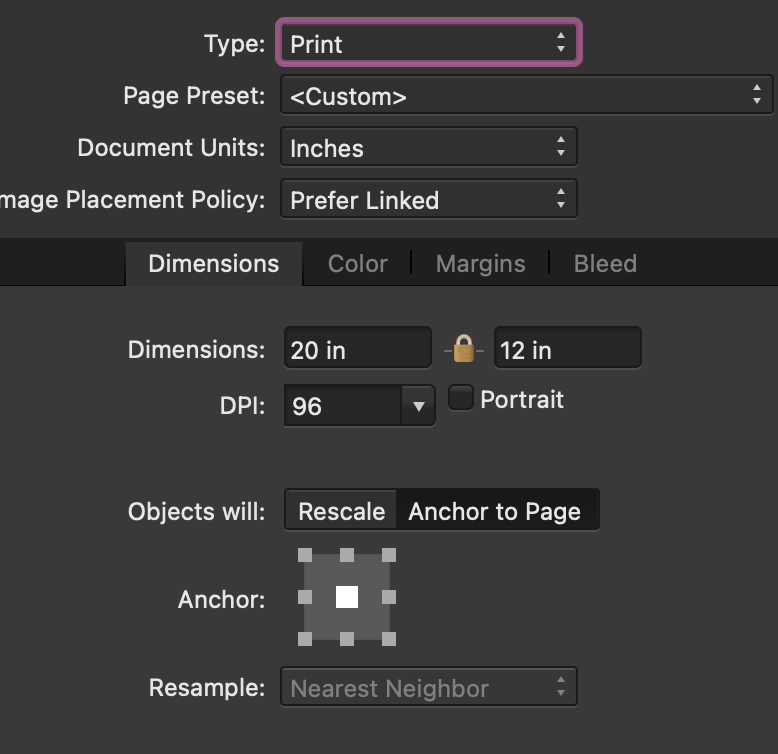

I have Pixelmator but never use it with the Glowforge. I use Affinity Designer. That being said though, is it possible to set up an ‘artboard’ in Pixelmator? If you can set one up in a 20"W x 12"H format, everything should load into the UI at the correct size. Also, the dpi number is important.
I know they’re not the same programs, but this is what my settings look like for the preset I use all the time…maybe it will give a bit of insight. Good luck to you!

Yes, the secret is DPI (dots per inch). The must match what the GlowForge is assuming which seems to be 96dpi (I dont see a way to set this anywhere).
WHen I export my rectangle .svg at 96dpi, GlowForge imports very close to the correct size.

The reason it’s only close and not exact is that the :glowforge: doesn’t have a set DPI (which is why tech support didn’t tell you a DPI) - it’ll do whatever is in your file. It’s up to your drawing program.
Seriously - the 20x12 drawing area, bed, frame, whatever Pixelmator calls it will mean that the dimension are exact no matter what you set the DPI to!
They can. But in practice 99% of SVGs use pixel dimensions, not real-world units. (Which makes sense; SVG is mostly targeted at on-screen use, primarily on the web.)
To convert pixel units to real units you need the conversion ratio, usually expressed as “dots per inch” or DPI. This used to vary widely, with some programs defaulting to 72, others using 90 or 100 or 110.
But at some point a few years ago most SVG-based software started to converge on 96 DPI as a default. (Mostly because web browsers always assume 96 DPI, because of how CSS defines pixel units.) So for best interoperability one should always export SVGs at 96 DPI.
Alternatively, one can use PDF as that format always uses real-world units.
And on the Glowforge there’s a third option: always make your file exactly 20 inches wide and 12 inches tall. When the Glowforge software imports a file with that 5:3 aspect ratio it ignores its usual assumptions about DPI and scales the file as needed to make it 20×12. (Or at least it has in the past; I haven’t tested this recently.)
