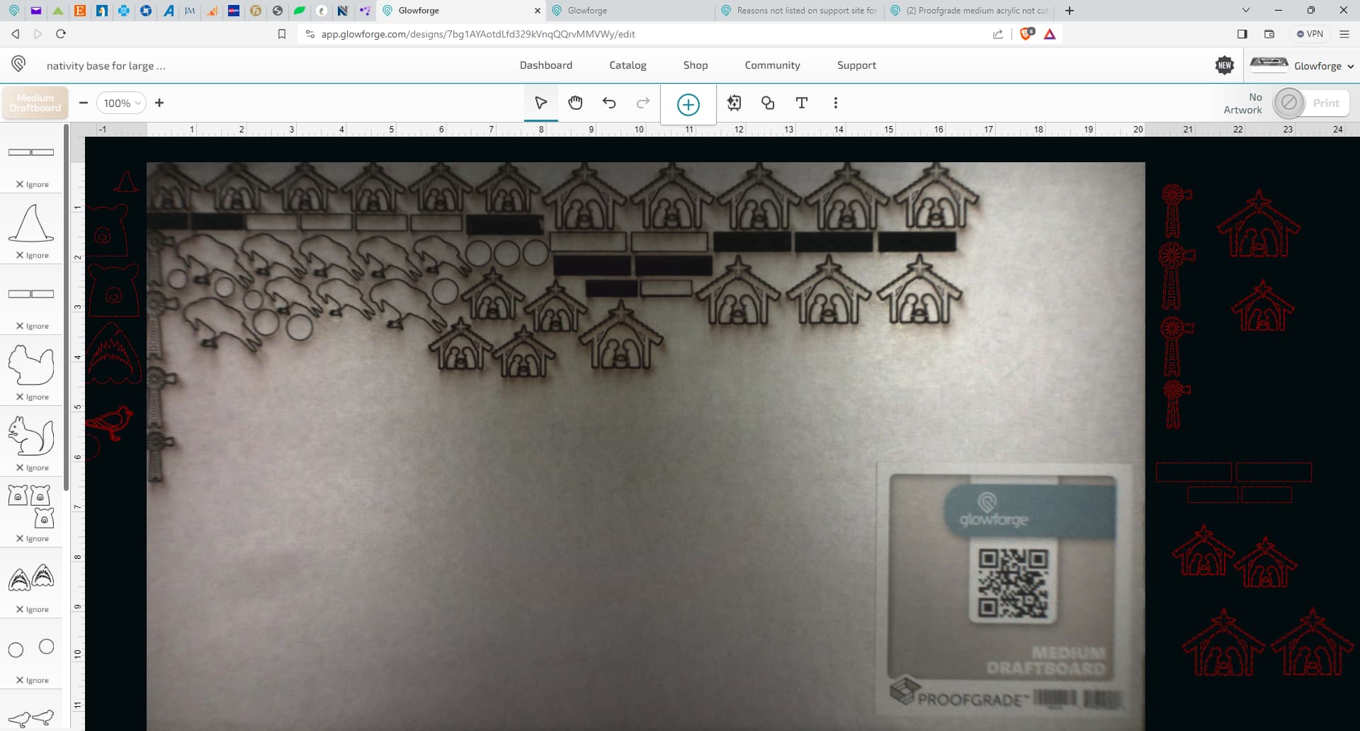

my laser isnt cutting through medium acrylic and medium mdf. I have looked thru other posts and cleaned everything I can clean and I’ve calibrated camera. Will cut through eco thin acrylic fine. any ideas?
Which machine do you have?
The lid camera has nothing to do with the actual performance of the machine, it is only for design placement. Are you certain that you have cleaned all of the optics? Can you share a screenshot of your material on the tray and your settings?
Glowforge plus. Laser Lens looks fine. Fan is not that dirty since its been replaced recently. Setting are GF for medium MDF cut.
backside of MDF, if I press hard it rips piece.

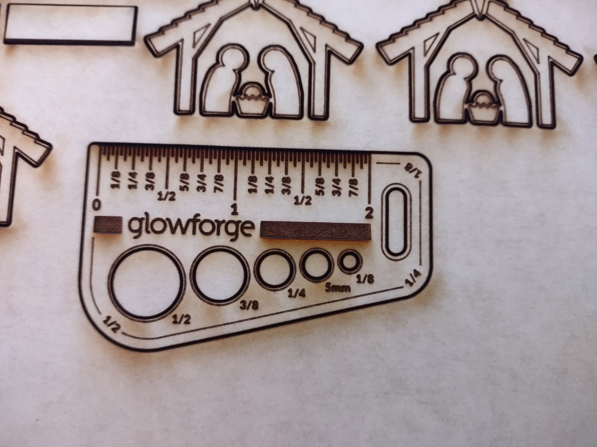

So it is close to cutting all the way through if you can push it out. The lines of the design seem wavy, but that really should not be the issue. Have you cleaned the windows in the machine and on the printhead. Can you double check the lens and mirror for smoke residue or smudges. Finally, after cleaning the optics one more time could you print the Gift of Good Measure and photograph the front and back upon completion? Support will look at the photos and the logs of your machine and determine the best course of action. To complete your projects you can try slowing your speed slightly.

I just cleaned again. It’s better even though not like it usually is. My pieces usually just fall out.

I’ve done that one several times. The good fortune print was almost normal, just slight tearing of MDF on left side. So I’ll wipe again because it seems the more I do it, the better the print gets.
Just tried to print one of my nativities and it was bad again. So I have no idea,

Send the photos along with the date and time of the print to Support. Then slow your speed by 10 and see if you can get some things cut cleanly.
So all good points. Board is flat. Could be older draftboard since I ordered from Michaels and who know how long it was in their warehouse.
As for speed, when I slow speed to 490, it does nothing. No laser. It acts like it is cutting, head is moving to shape but no laser is visible and nothing is burning. Very weird. (Edited…adjusted speed on wrong place…cutting now at 158)
VICTORY! Slowing the speed worked! So maybe indeed an old board and slowing it down worked! Thanks for the help:)
