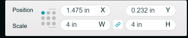

Before there was passthrough, I set up a system I still use now,
If your material is hard against the right side, your x-values and rotation can be fixed. Then I break the cuts into individual items (different colors) but place them properly. This gives you the chance to pick where the break points should be (the big advantage of my style).
In picking the break points, sometimes near horizontal lines do not need breaking at all, and if the breaks are not on a single y value, it does not matter, so you try and just pick the places where the lines are vertical. If you make sure that you use the Focus command and check the real numbers on the popout, you can set the y value to your known distances and you should have very accurate cutting.
Making sure that each piece totals no more than 10.9" tall, you do not even need to evoke the passthrough command.

Not really. It is pretty straight forward. They recently moved this…
anyway. The rows of dots are about where you are measuring from with 0,0 in the upper left corner, which is away from the edge. So you will be measuring the lower right corner instead of the upper left shown here.
